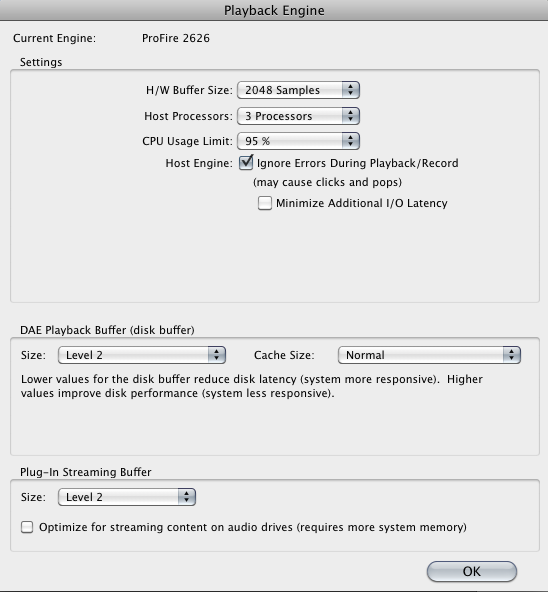

First you want this menu:

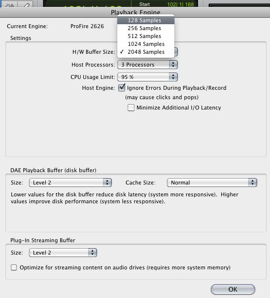

Then in this screen (which might look different than mine):
You want to lower your buffer setting down as low as you can.
If you do that and your computer yells at you (you get an error message after recording or playback) then your computer won't keep up. To combat this turn off all your plugins execpt maybe the click track (hold down option alt/option+command and click on them) and try again.
If your computer still won't do it then you may have to resort to turning that HW buffer setting back up a little. I would try to stay at 256 or below though.
