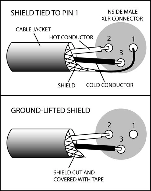

OK, I did not realise this, in this case what you have is a ground loop between the bass amp the preamp and the audiobox (more likely the computer connected to the audiobox). You could try lifting the shield on pin 1 of the XLR at the Audiobox input (see diagram). This does the same as the ground lift switch that is on a DI box. If you don't want to do the wiring thing, there are cheap XLR ground lift connectors you can use.
