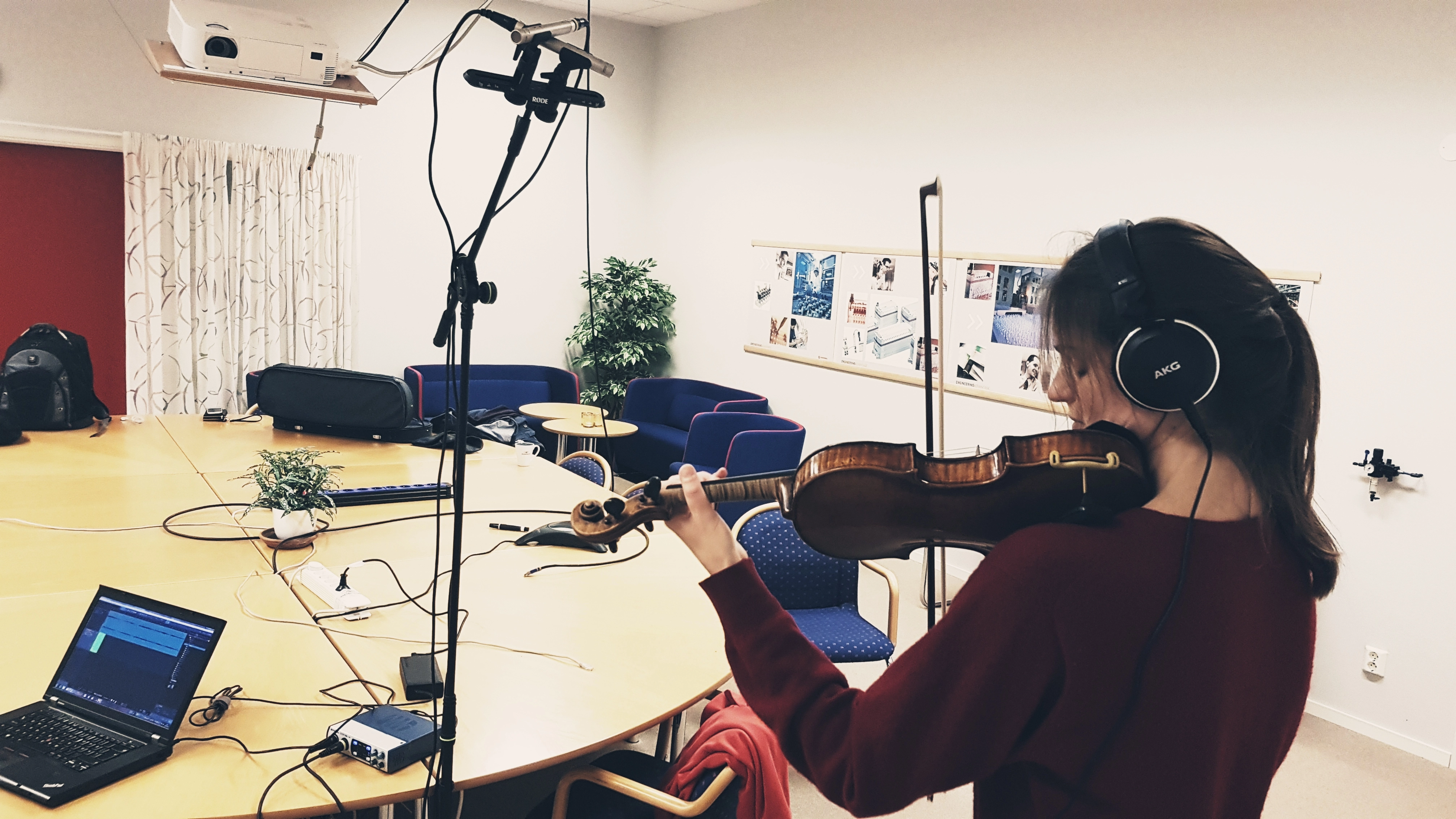

I have bought as a present for my girlfriend a Presonus Studio 26 DAW with Studio One Artist, A matched pair of 2 microphones Rode NT55 and a pair of KRK RP6 studio speakers to record some classical violin tracks.
I am trying to help her with the recording and, despite my total ignorance in the subject, we had quite good results and I also had quite a lot of fun in learning all the necessary and experimenting.
She plays a classical historical violin and also a carbon fiber model for "modern projects" (still acoustic).

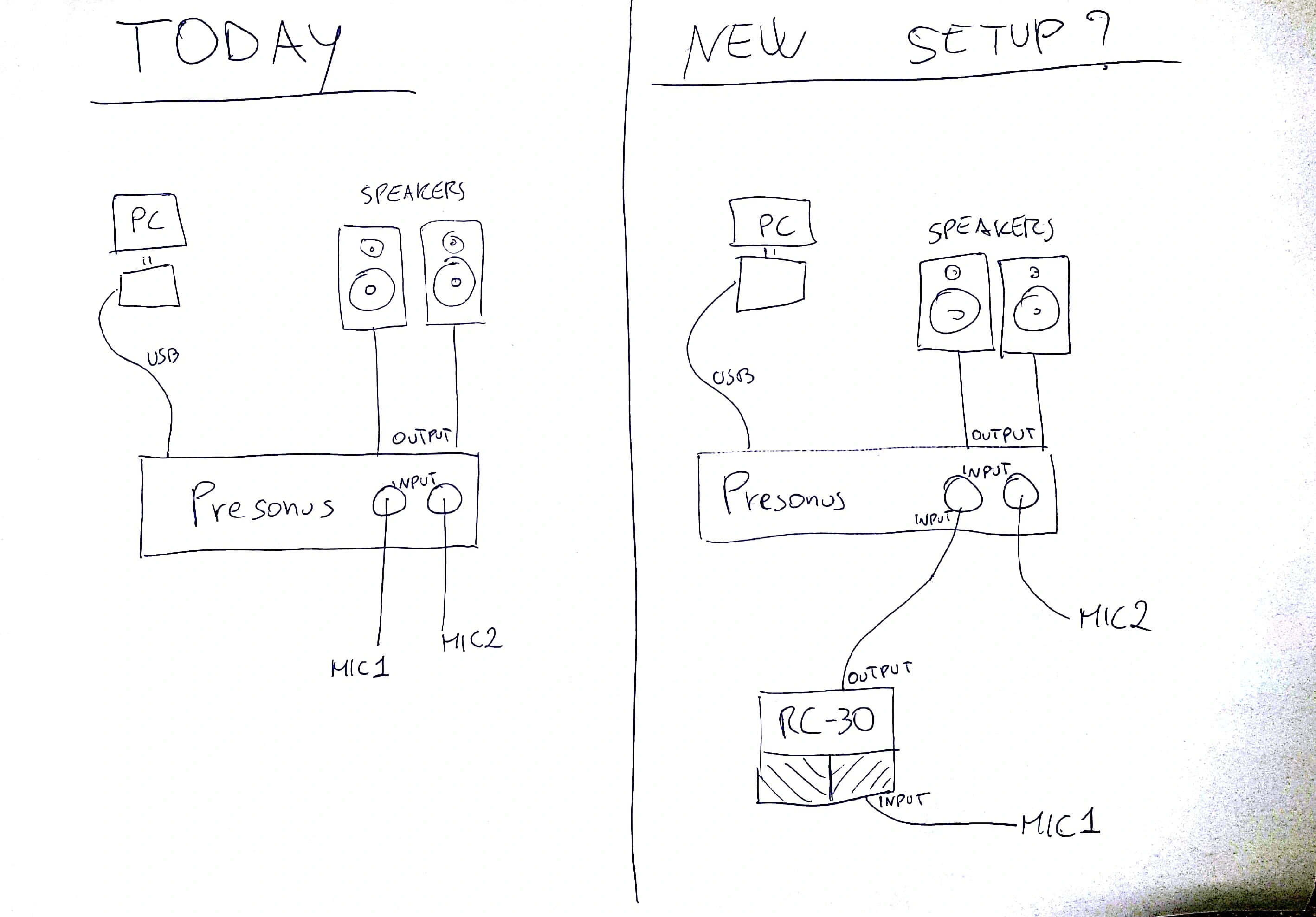

Hello and thanks for your advises.
Does that means that I need to connect everything as before with the difference that I will connect one microphone to the RC-30 input and connect its output to the input of the Presonus?
Will that be OK?
IMO, the Boss is more a live effects pedal. You should be able to record a section in Studio One, and create a loop, hit recording on another track and record the new track with your loop. No loop pedal required. Especially with an acoustic instrument, having two mics always gives a better recording and with the Boss, it limits your input for the mics.
Will that be OK?
Yes, the R/H configuration should work. N.B. you will not be able to have the speakers active AND a live mic, feedback. You will need to monitor on headphones.
The output from the RC-30 needs to go into a 'line' input. Some AIs don't have them but a 'high Z' guitar input should serve.
All props to DM-60, his might be the better way to do things but do not be afraid to experiment. You can plug almost any audio output into any audio input. Might not work, might hum, might feedback but keep gains low and advance them slowly! Nothing will smoke.
I agree with Dave, don't be afraid to experiment for sure. Just understand what you are doing. Nothing is wrong if it sounds right and it achieves your goals.
