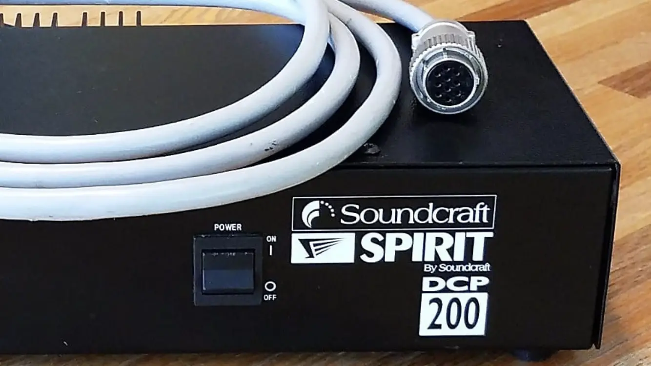

Where did you get the CPS-150 was crappy? And theDCP200 doesn't have the connector the CDP-150 has - I wouldn't do it - but that's me.I am going to be attempting to use this power supply with a 24CH Soundcraft Auto Mixer. This mixer comes facotry to be powered by the crappy CPS-150 but I think using the DCP200 would be an upgrade. What do ya'll think? Thank you!

The DCP200 outputs 17.1v - 2.1 amps - the CPS-150 outputs 17.1v -2.1 amps - so they are exactly the same - CPS-150 has a MultiPin output and the DCP200 has a MultiPin output - I didn't know that - so there is no difference between the two - the OP decided to call it 'Crappy'.I just digested this…I stated in my previous post we don’t know if it’s the same or not, but here we have out answer to that. Thanks.

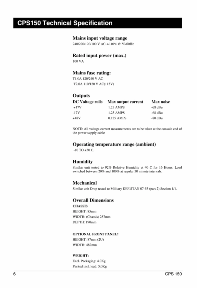

Not correct on the amperage rating, at least according to the service manual for the CPS150 on the Soundcraft website…see page 10 of the pdf found here:The DCP200 outputs 17.1v - 2.1 amps - the CPS-150 outputs 17.1v -2.1 amps - so they are exactly the same - CPS-150 has a MultiPin output and the DCP200 has a MultiPin output - I didn't know that - so there is no difference between the two - the OP decided to call it 'Crappy'.

The +/-17V audio power rails are rated at 1.25A each. Where do you see they are 2.1A?

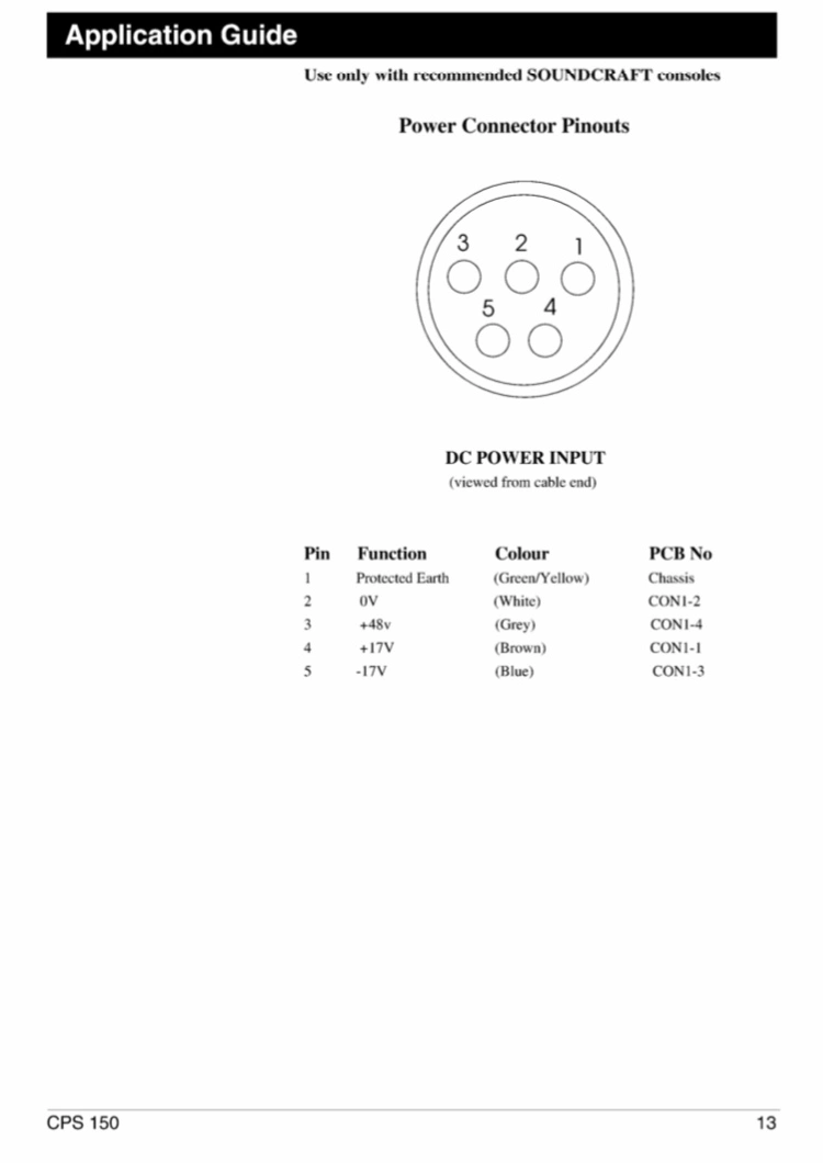

And, wait…you originally said the two power supplies, the CPS150 and the DCP200, had different interface connectors, but you’re now retracting that? You didn’t really know that? Are you saying you know for fact the are the same or do you really not know? Just because they are “multi-pin” doesn’t mean they are the same. There are literally thousands and thousands of different “multi-pin” connectors in existence.
That’s because you’re not following what I said. You’re probably looking on pages 9, 10 or 11 as numbered in the document. I said “page 10 of the pdf…” which is page number 6 on the document. You also could have just looked for the specifications page. But I’ll help you out with that:You can read it on the back of the devices - now it may only pull 1.2A but its probably rated at 2.1A - and just draws what it needs - BTW in the PDF you cited there is no reference that I can see to the Amps on Page 9 -10 - or 11.

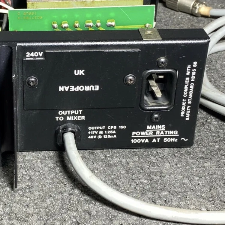

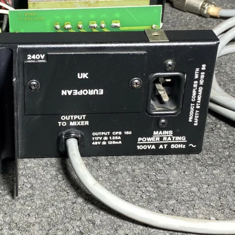

Every picture I find of the back of a CPS150 shows +/- “17V @ 1.25A”:You can read it on the back of the devices - now it may only pull 1.2A but its probably rated at 2.1A - and just draws what it needs - BTW in the PDF you cited there is no reference that I can see to the Amps on Page 9 -10 - or 11.
I must have been dyslexic for the moment.Every picture I find of the back of a CPS150 shows +/- “17V @ 1.25A”:
So are you just conjecturing again on the 2.1A for the CPS150, or do you have one that is factory screened 17V @ 2.1A or…? What is your resource that verifies the CPS150 17V rails are rated at 2.1A?
