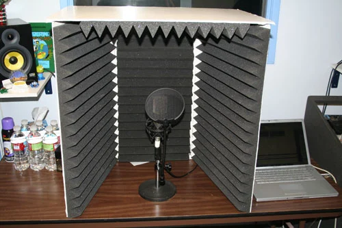

I'm working on a DIY solution for my needs (where I'm in a small apartment where acoustic treatment isn't possible and the layout isn't sound-friendly). Basically, it's a way to isolate my condenser mic using panels that I can easily fold and store away for later use (hence NOT a booth, which given my space limitations would not be very possible).
Just curious to see if anyone else has used similar treatment, particularly if they use a condenser on a mic stand.
Here's something very similar to what I'm pursuing: booth-with-lid.webp
What do you guys think? Creative acoustic treatment in a tiny space? Or useless gimmick?
I believe the biggest issue with something like that pic you posted, is that you have effectively created new issues with close proximity reflective surfaces.
Put your head in a box and speak. The low end sounds 'boomy' and like you are talking into a box. Auralex or any foam only helps with upper frequency ranges.
I do not see how that would work well really. Yeah, you may stop room reflections but at the same time it seems you would be adding worse issues.
Maybe for spoken word stuff that might be a good thing, but if you are belting out some killer rock vocals, not so much.
This is all coming from a guy who has never actually tried something like that. So take it as speculation.
To add, I would think that a breathable box without solid walls, made of rockwool or something similar would do the job much better.

I'm not sure how the fold-up box will work. I'm inclined to think the dimensions are too small to worry about low freqs. You might get a boxy sound in the upper mids, but the auralex will probably absorb in that range. Have you actually used it yet? Need a sound clip.
I'd think along this way as well. I'm more familiar with fiber glass, not sure you can do this with the rockwool I've seen.. But 2 or 3" of the med. density (check these numbers.. I think it'd be '702?) would be stiff enough just wrapped in cloth to not need a backing at all.
For one, you probably don't need to block the sound coming from the room entirely, (and you won't anyway as long as it's not a 'total seal'.) And skipping the solid sides and top means you're getting the full benefit of the 2 or 3 inches of absorption -way better than 'wedge cut foam BTW. (think about it; the dips' in the cut, = much thinner) and the thing also can't end up resonating like a 'box.
You could probably just loosely attach the sides (tape may be enough) and lay the top piece over. Dissemble and stack'em when your done.
Separate pieces like that you can also set' them as you see fit for various mic situations.. a more open V' shape for more width for example. The edges don't have to be 'snug', even gaps here and there you're still getting the general control the stuff does around a mic.
I know the OP wanted a home built solution but I have to +1 the idea that the sE Reflexion filters are worth the money, particularly the PRO one.
However, if that's not an option I have to agree that putting a box all the way around the mic (and so close to the mic) is not a good idea. If you do go that sort of route, you want most of the deadening behind the mic and either side...but no farther forward than in line with the mic capsule and/or a bit farther away.
The other thing that helps is some deadening material actually behind you. What I have for spoken word is a folding carved wooden screen. When recording, I hang a movers blanket on the back and pull it across behind me. This gives pretty good results even on the spoken word where you want a dead acoustic.
Otherwise, as I've recommended many times, you can make a framework out of cheap PVC pipe and use this to hold a movers blanket or duvet behind you--if you don't glue the joints you can take it apart and keep it in a closet or under the bed when not in use.
So far I'm just researching different solutions and costs, so I don't have it built/don't have a sound clip. The picture is something I found on a site (forgot which one) and was curious to see what y'all thought to see if you think they were just BSing on the site.

Someone mentioned not using the wedges, as well as not needing the panels to be tightly stapled together. Definitely sounds like a good idea, but unfortunately I'm gonna have to put any DIY project on hold for a month or so.....
Regardless, I appreciate all the valuable advice. I'll keep you posted when I've made any progress. In the meantime, I'm gonna try and record different styles of vocals and music and see if my room really is as acoustically bad as I would imagine that it is.

If I were to build something like this today, I would build three 2ft X 2ft/3ft panels using 2" or 4" covered compressed fiberglass (OC703 et al) using as little framing as possible then create a mounting system so each panel could be quickly and easily attached to a microphone stand.
I've also been thinking for years about creating an acoustic panel that incorporates "Limp Mass Material" behind the acoustic material because Limp Mass Material will, generally speaking, stop sound straight away.
They'd be a tad heavy though. :laughings:
!!! Just as important in all of this is having something similar behind the vocalist because that is where the mic capsule diaphragm is pointed!!!
...The other thing that helps is some deadening material actually behind you. What I have for spoken word is a folding carved wooden screen. When recording, I hang a movers blanket on the back and pull it across behind me. This gives pretty good results even on the spoken word where you want a dead acoustic.
+1 This is also as good, and just as likely better way to look at the solution- I.e. looing at it as sectioning off around a mic area- and keeping the options and flexibility that opens up.
Hung sections (or the gobos'-fiber panel approach) behind you, and consider above for ceiling bounce. (It can easilly be closer if you're standing with a mic than any wall..
