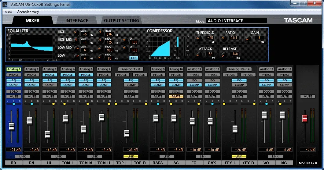

Rob, I think you have the US-1800, which doesn't have the DSP chip, but the 16x08 has compression and EQ in the control software. It's channel assignable. You can pair channels and control incoming signals, much like a mixer. It's a bit crude, but it's there. You can set and save scenes, and use the unit as a mixer when not connected to a computer.
One of the things to remember is that every time this launches you will need to "LOAD" a scene. It is not "sticky". It took me forever to figure that out.
Also, in my experience, the driver loads from the "Start" menu. So, if it starts, and you cancel it without loading a scene, it will cause a world of hurt.
What I did is use the most generic version "16 X 16" or whatever it is now. Load it, and forget it. That's one of the reasons I hated it. It sits right in the front end.
It's also necessary to make sure the sample rate and buffer size it consistent throughout the signal chain or the latency is unbearable.
What version are you using? Early on it was two separate pieces, but with v4, it's all combined into one file and loads at bootup like any driver.
