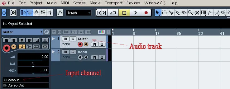

Well it sounds like you have the Alpha selected in Cubase, but let's make sure.
Install Alpha driver 2.7 from HERE
In Cubase; Devices>Device Setup...>VST Audio System>select the Alpha driver from drop down menu. Check that 'Release Driver' box while you are there.
Now, go to Devices>VST Connections (F4), and create a mono Input bus.
Back to project window. Project>Add Track>Audio>Add track (mono).
Now, in the Inspector window, far left of screen, select the mono bus input you created. Arm the track, and make sure to toggle on the monitor button (looks like the side view of a speaker). This will allow you to hear the input while recording. It must be toggled off to hear playback. There is a setting in preferences to make this toggle itself when recording. File>Preferences...>VST>in Auto Monitoring drop menu, select Tapemachine Style.
See if this gets you going. :)

The 'Release Driver' checkbox, only allows Windows to access the interface while Cubase is open. It won't change your issue. I am guessing it is the monitor button, and or VST Connections that are screwing you up.
Let me know what you figure out. :)
