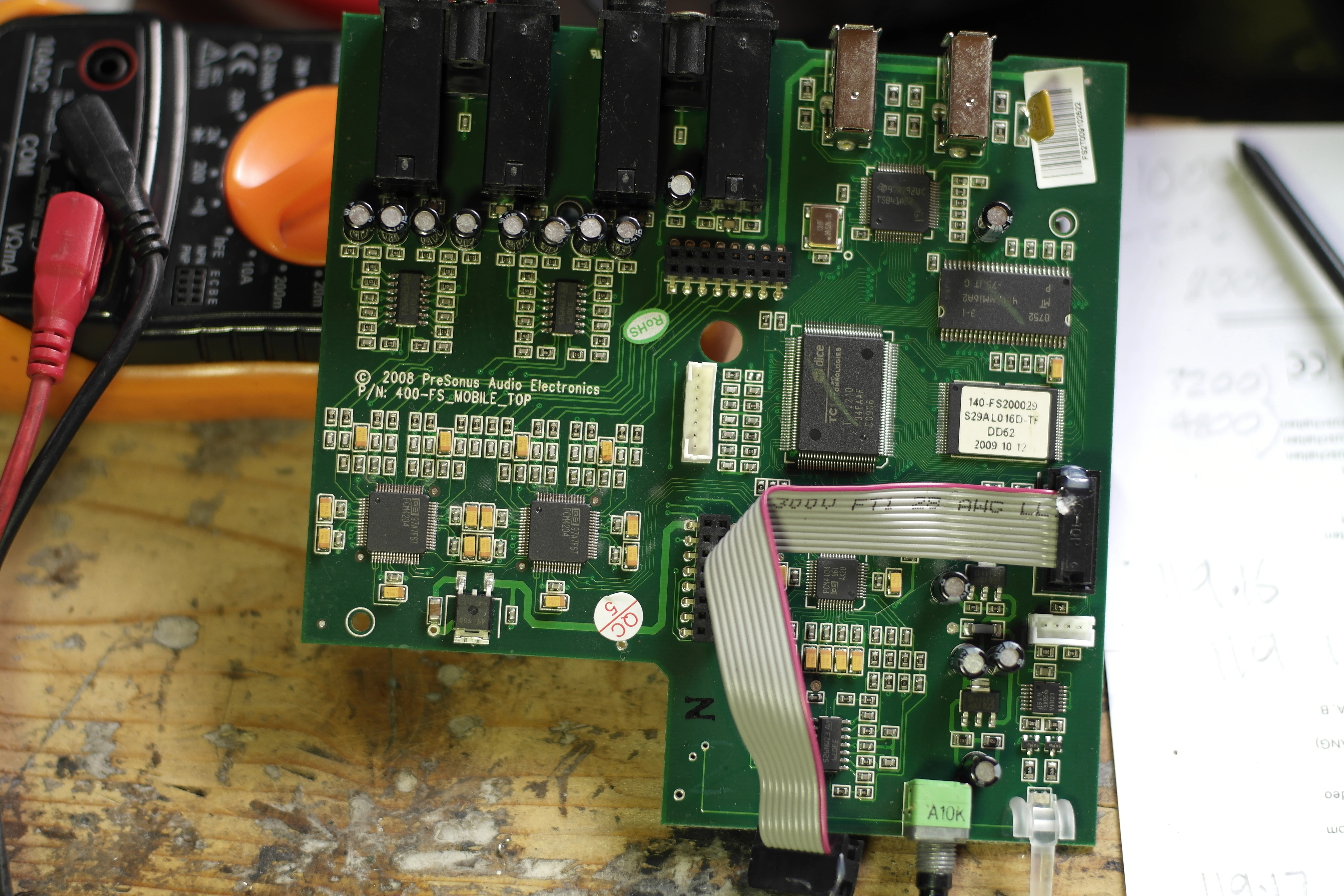

In the first row of 12 smd components above the combo jacks in pic one, reading from the left 3,5,9, and 11 appear to be 6.8k resistors, and read as such.
They're black and marked '6811'

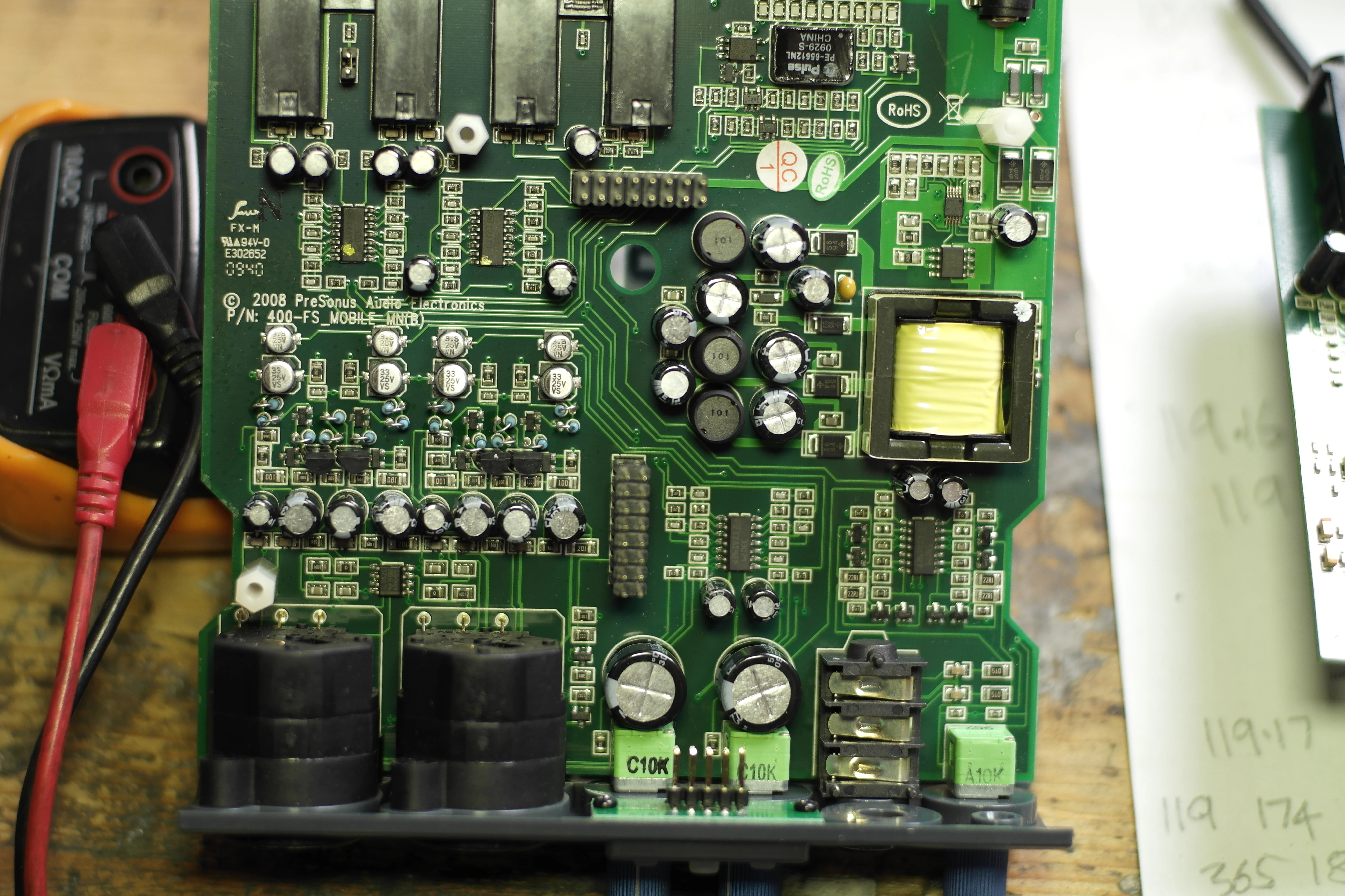

The row of caps above that - None of them is open to ground.
I presume these images will be HUUUUGE on some browsers. Apologies, but detail is important here.
If you save-as and zoom, you should be able to read everything I can read! ;)
Main Board.
Top Board.
The only thought I have is since there is some symmetry in the components of each channel behind the XLR's, maybe some voltage comparisons on the components that appear to have the same function on each side. Beyond that not much I can suggest.

Looking at the pre amp photo it seems to be a variant of the bipolar transistor+chip mic amp and I suspect a transistor has been slightly buggered.
WTGR! If you are not kitted out for SMT work leave it alone! Presonus might wash their hands if the board is mangled.
That input diagram shown should not use bipolar 22mfd caps IMHO. The 48V will polarized them. Further into the pres amp there should be bipolars to DC isolate the input stage when 48V is off., unless of course it is one of the (daft IMO! ) DC coupled jobs.
