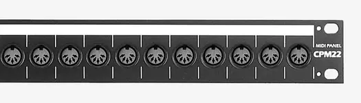

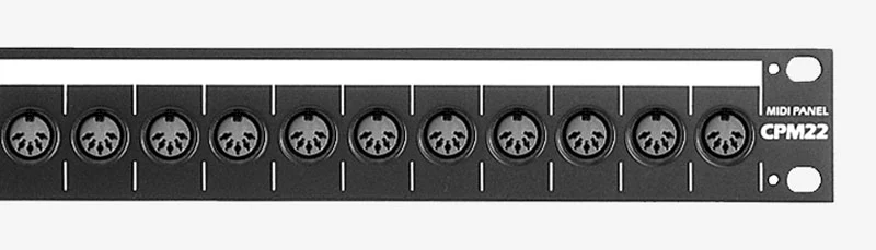

Well, one thing is for certain. I'm not the only one that has had a similar dilemma and tried to solve it himself.
<click me>
It's too bad this isn't even a close match to what I ultimately need. However, it's nice to see that this is more than just a little doable.
Carl
