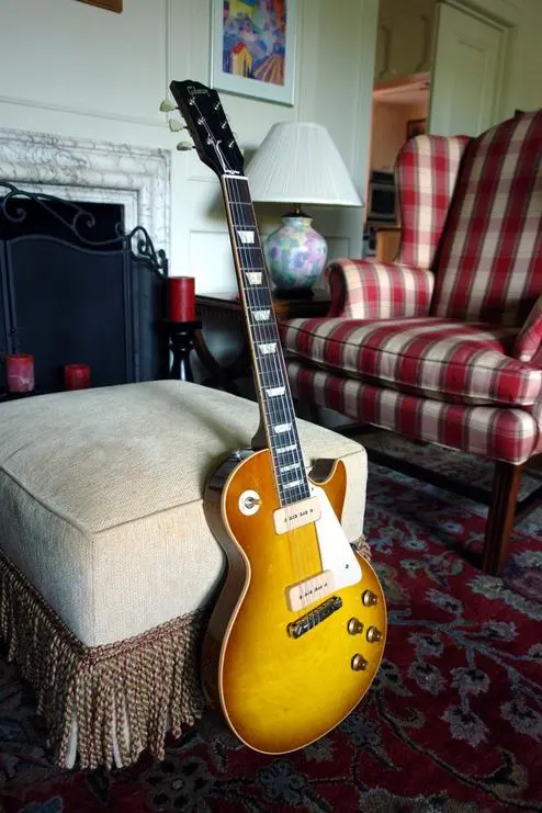

It's a Gibson Custom Shop 1954 reissue, manufactured in 2006 but new stock. It has an ice tea burst finish rather than a gold top. Gloss finish, not the aged VOS finish. Very pretty one-piece (not bookmatched) maple cap with grain curvature that follows the lower bout. The burst is very light and the grain shows over the whole top. One-piece wraparound bridge-tailpiece.
I promise not to hog the body out on this one for a humbucker. :D
Here's a pic:

That is one gorgeous guitar ZB. That's my favorite configuration for an LP.

Thanks, Milnoque. As usual, my photography is lacking and does not do the guitar justice.
