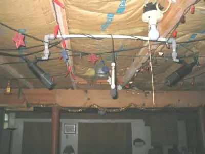

attach the mic to the ceiling. even though we don't use drums, I have my mics (V67 and V57), 2 of each, attached to the ceiling. Here's the deal. I got some 1/2" rigid conduit, 2 pcs 4' long, and fixed them to the ceiling with little u-shaped clamps. I attached a 90 degree coupling at both ends. I then can put another pc. of conduit (how ever long I want for the situation) hanging down. I got 4 plumbing fittings (some type of threaded coupling thing, I took the mic clip with me and tried until I found one that fit), and attached the mic clip to the conduit via another coupling. It's easy to attach and un-attach. when we record, we just get in a circle right under the mics. :D
the first time I did this with plastic stuff, and ended up redoing with the metal conduit. This pic is the first one I did with plastic, but it'll give you an idea of what I'm talking about.
