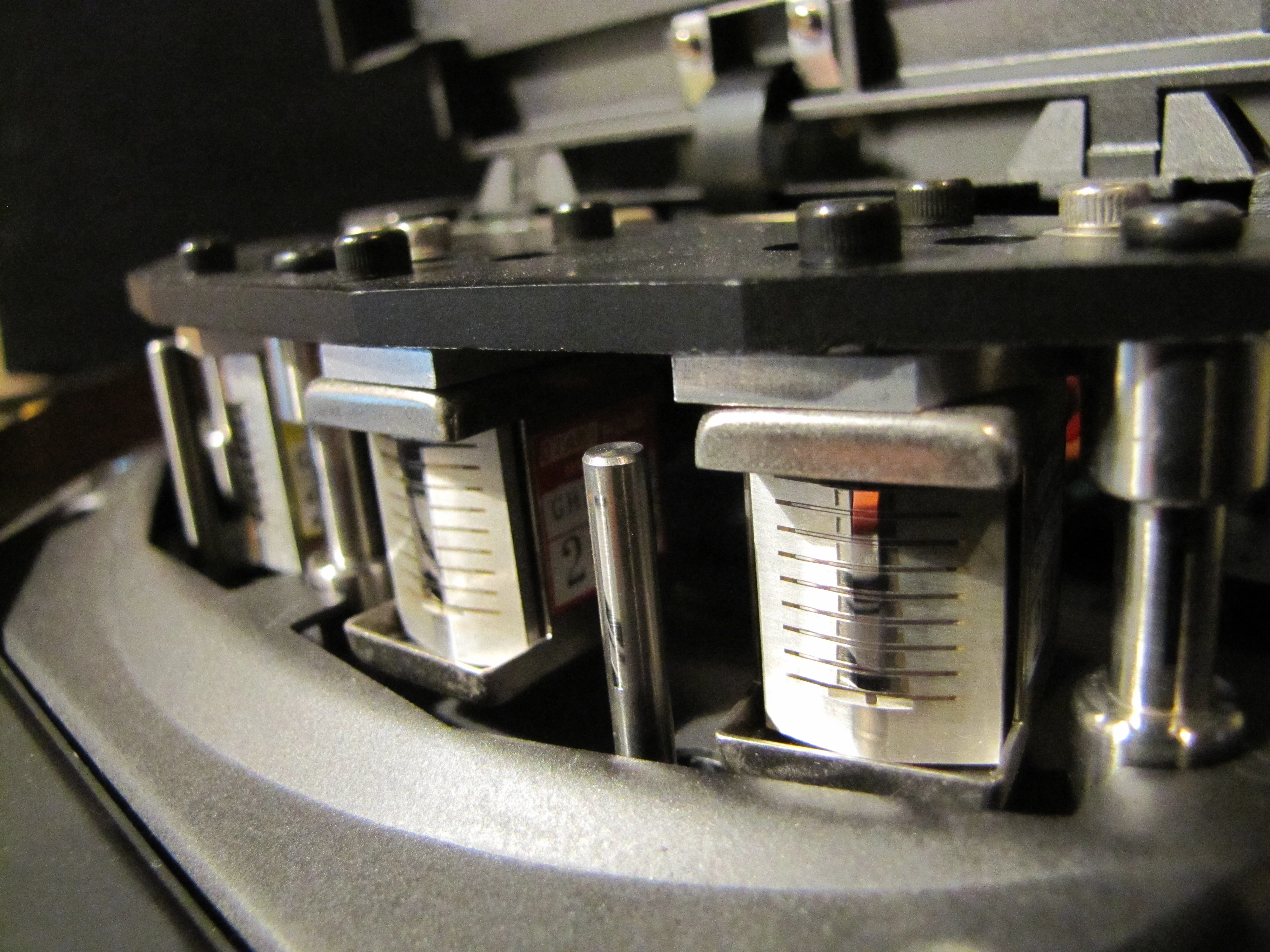

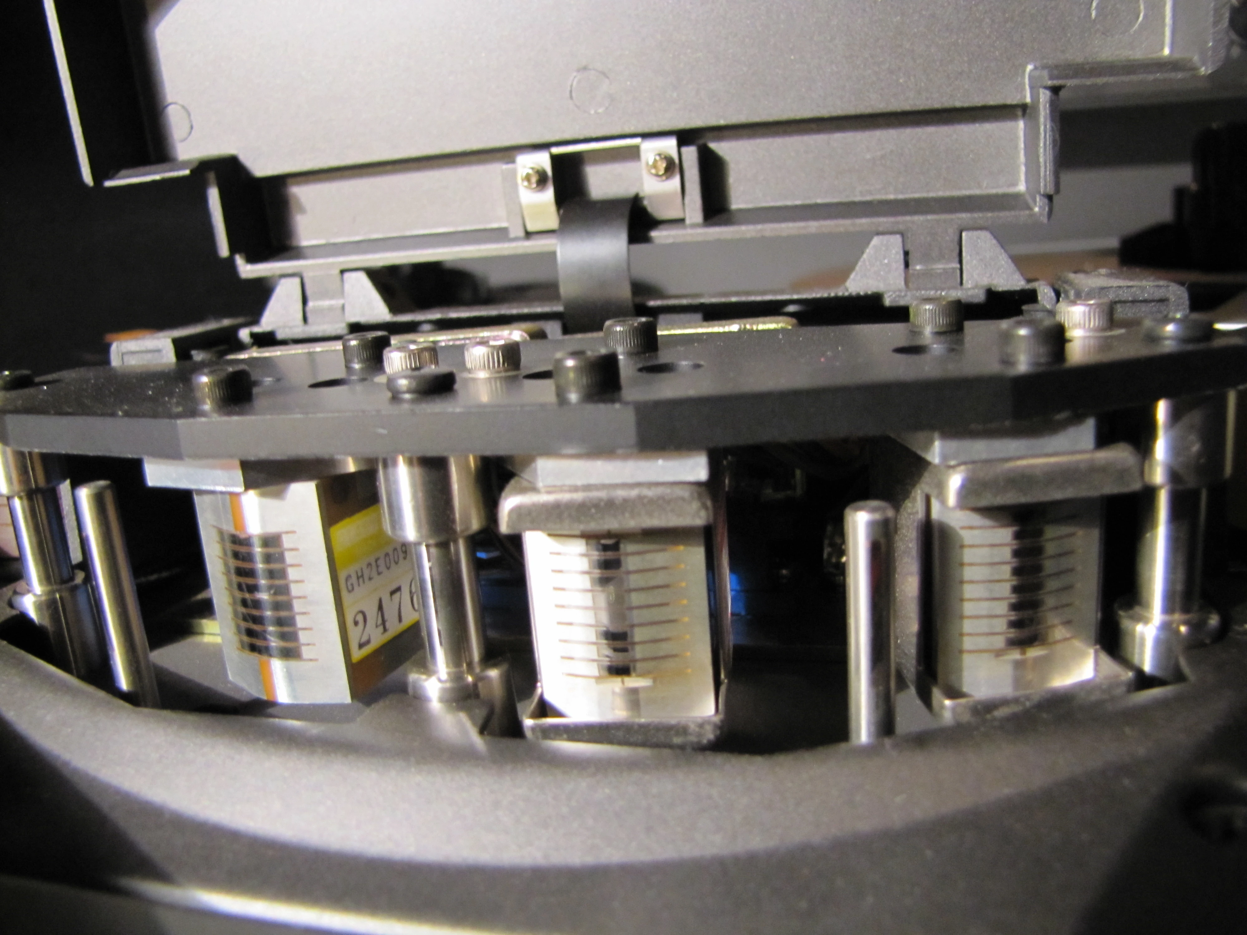

I just opened up the back and none of the capacitors seem to be bulging at all (which is what i've been told bad caps look like).

View attachment 78349View attachment 78350
Not all head problems are going to visible or obvious to the naked eye, which is why JRF Magnetic Sciences does head reports. Nor do leaking or failing capacitors always bulge, as that is only one visible symptom of only one type of failure. How about these additional trouble-shooting methods: If you input a signal (try a CD of music) and set the Otari's output to monitor the source instead of the tape, do you still have the same problem with the audio? When playing the MRL tape, does the audio change if you monitor off the record head versus the repro head? How about if you play a completely new and virgin RMGI tape with nothing on it... are there still noisy pops and crackles in the hopefully-silent audio output?
