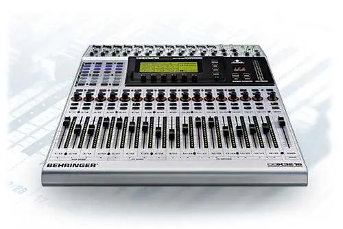

LOOKING AT THIS DDX3216 DIGITAL FROM BEHRINGER...
Does anyone use it and have pro's or con's on it.....

pro's:
Cheapest fully automated mixer around with "ALPS motorized faders"
Different interface options (ADAT, TDIF, AES/EBU)
Surround mixing
32 channels
12 XLR inputs with phantom pwr (I think)
Seams easy to get around in
Cons:
Reliability (my friend had to send send his back and get a replacement before he even had anything but the power cord hooked up)
To fully use it you need to buy one of the above interface options (otherwise you only have "4 multi-outs")
Manual could be better
That's all I "KNOW" I not going to comment further on something I really haven't used (read: not going to bag on it just because it's behringer, I wonder if it didn't have that name...), but the reliability issue would worry me, he did get the extended warranty, but even with that, if it breaks down your with out a mixer while it's getting repaired. I'm not sure how your going to be using it, but if you going to be using it with computer based recording (multitrack), I'm going to be upgrading soon and thought it would be (look) cool with flying faders and all, but will go with an interface box, thinking about two Roland/Edirol AU-1000 myself (I to wait for a few reviews first)

I want to use it for my fostex VF-160 . It does say it has 8 aux's
and 16 buses. But at the site they don't show the over head view
all usually have the eight output's ... that's why im asking...

What equipment do you need to add inputs beyond the 12 XLR inputs that are allready there?

If you have the ADT1616 adat option board installed you can simply get an ADA8000 preamp-AD/DA which will give you 8 additional mic input channels for total of 20 mic inputs and if that's not enough you can buy another ADA8000 for total of 28 mic inputs.

I seriously considered the Behringer DXD last week, but then opted to get an Allen & Heath 16:2 and an ADAT converter. Same amount of money (like a grand or so), much less features (no track automation, no FX, no moving faders, no digital routing options, etc etc etc ) ... but it just sounds better, and that'll all that matters in the end, I guess.
