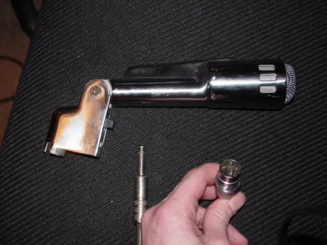

Here is a picture of the mic and the cable ends.

ok, that's cool
F.S., thank's for postin that pic - i totally get the 4 pin connector thing now. Your right, IS a beautiful mic! One of the instruments i was thinking of trying this mic on was actually few hand-percussion instruments - including a dejembe drum....Tonewood, your positive experience with this mic and that type of source has me encouraged!!!! Can't wait to try this out!
T
After looking at the picture I think what they meant by "adjustable" is that those connectors had a 2-way key, so that the connector could be plugged in one of two possible ways. The mic elements were usually wired so that plugging the 4-pin into the mic one way gave you high impedance, while reversing the plug at the mic would give you a low impedance.
This allows you to plug the mic into a high impedance guitar amp, or switch the plug and use it into a board.
The downside is that either way it's still a 1/4" phone UNBALANCED connection at the other end... Steve

that's hard to picture Knightfly: The plug is indexed for only one direction. You can only insert it one way into the mic. I do however have a cord that goes to 1/4 inch mono and one that goes to 1/4 inch balanced/stereo. The cord that goes to a balanced/stereo 1/4 inch has a shure brothers transformer near the 1/4 inch end. the transformer is about the size of a hand grenade.
