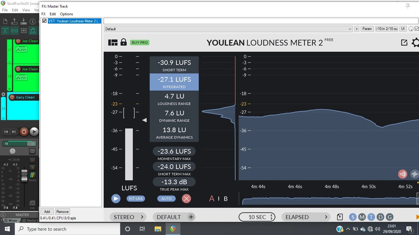

Just something that I have found with Youlean, if you put it on the master track, it is probably pre-master fader. That means if you up the master fader, Youlean won't see the level change. It might say your peaks are -2 and if you bump the master +4, you clip. Your rendered file has different specs than what you saw premastered.
Keep the master fader at 0 or even -1 and you should be OK. I don't know if that's a factor with your mix, just something I've seen.

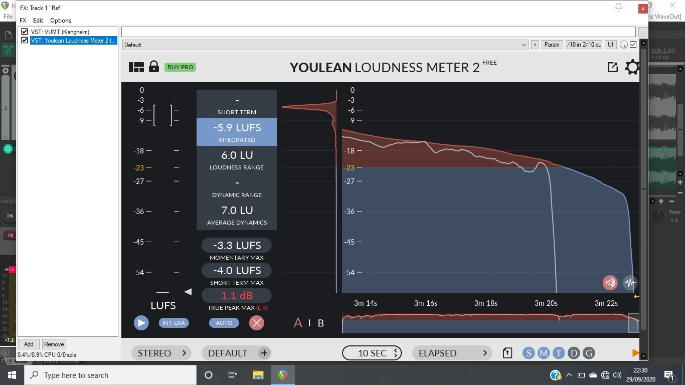

Part of my rethinking has been about what my goals actually are, and how I want the music I make to sound. On reflection I think I was focusing way too much on that one reference track because I saw the style of that track as being the closest I had to the band that I had recorded. However, as much as I do like Black Stone Cherry, in truth the music that I personally love/love the sound of the most is the rock/grunge/metal of the early 90's. So I spent some time doing some research. I basically ran a load of the type of music I love/would like to be able to produce through Youlean, and I have also done the same with some of the tracks I have that have been recorded in "proper studios" by bands I have been in, that we were happy with the quality of.
The 90's stuff is WAY quieter in the master than some of the newer stuff. I even ran a remastered Pearl Jam track that was louder than the original 90's one, but still coming up over 2 LUFS quieter than Black Stone Cherry.

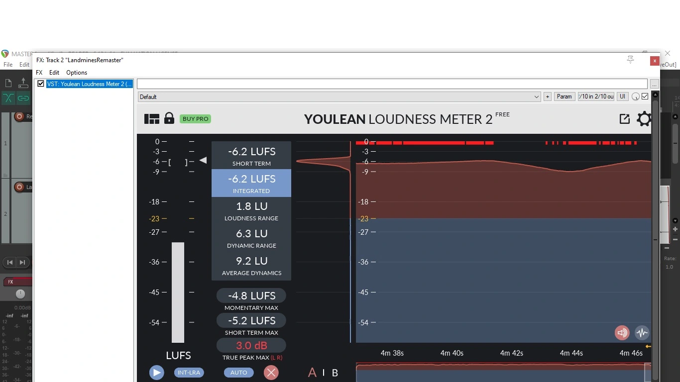

So, anyway, what I drew up was a table that included the major points from the Youlean meter, as well as the RMS level of all these tracks, and then an upper, lower, and average amount for each value.
My thinking is that if I am hitting somewhere between the 90's and newer recordings, that should be a perfectly acceptable range where they still sound "new(ish)" but retain an older aesthetic (and make it easier on my cheap equipment not to clip the hell out of a track lol)
So, this is my latest attempt. I have tried it on a couple of speakers in my house, and haven't noticed anything too terrible with it, although I haven't had chance to try it out in my car yet, which is where I have picked up problems before. On the Youlean though I am pretty much in the range of the table I drew up. The only issue I can see from the Youlean is the True Peak is still coming in a little bit higher than it probably should be (although, all the "pro tracks" I ran through Youlean came up as above 0dB, mine is still higher), however it is still coming out lower than it was before, so I am kind of hoping that it is close enough.
So yea, let me know if there is anything you think I can still do better. I am still very much up for learning how to do these things better if I can. (and here's hoping this new one isn't a total mess since I haven't done the car test lol)
View attachment LandminesLUFSRemaster.mp3

Yes, I have noticed it do that as well. I try to change the volume of the channel track rather than the master is I can to combat that.
Having said that I have my master fader set to -1 now, and with the limiter set with a -0.1 ceiling it's coming out at -1.1 :)
