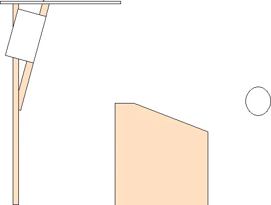

I am working on my control-vocal room trying to figure out where to put my bracing for my flush mounts before I drywall. I figured it out, I THINK ?.
I am raising my proto-Js about 5" to reduce reflections off my mixing table. This will cause me to kick the bottom of my soffet in about 6" so they will point down to my mix position. They will be 5'6" apart and mounted in 3/4" chip board which will be well braced.
Please check out the attached rough draft and tell me what you think.
Larry

Worked for me larrye - that looks oK - watch Guruland - I'm about to do the same ;)
cheers
John

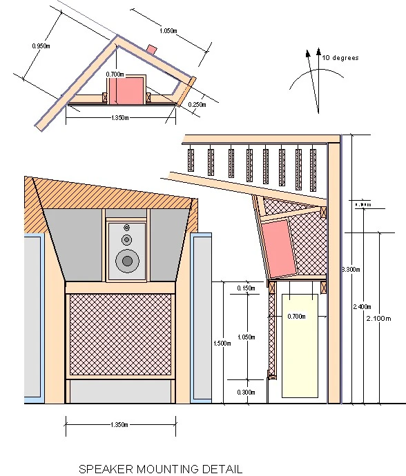

Larrye - once again, we seem to be doing the same thing :) Though I have been considering something more like the attachment rather then sloping the entire wall. I'm planning on putting in bass traps below the speakers on the vertical portion of the wall.

ausrock - I use Smartdraw cos it's easy to use. Corel is similar.
longsoughtfor - is this attachment what you are doing?? ;)

ausrock,
Sorry the attachment doesn't work for you. I used paint. I would be glad to convert it, if I knew how. If you save it as jpeg, will windows go ahead and convert it?
Larry
