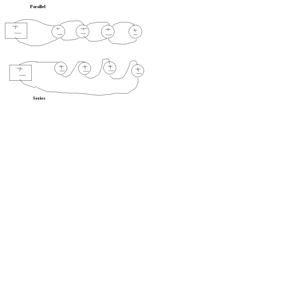

A 16 ohm 4X12 cab is typically made up of 4 16 ohm speakers in two parallel banks of series wired speaker pairs. If that is the case, and if you randomly disconnect two speakers it will either convert it to a 32 ohm cabinet (2 ways to do that) or make it not work at all (4 ways to do that).
You can make it an 8 ohm cab by disconnecting all 4 speakers and then rewiring a pair of them in parallel. An easier way would be to simply short out two speakers (one from each series pair), but you must be SURE that the cab wired as two series banks in parallel. You don't want to short the amplifier output.
R series = R1+R2+....Rx
R parallel = (R1*R2*...Rx)/(R1+R2+....Rx)
Series means from the positive terminal of the amp to the positive terminal of speaker1, the negative terminal of speaker1 to the positive terminal of speaker2, the negative terminal of speaker2 to.... the positive terminal of speakerX, the negative terminal of speakerX to the negative terminal of the negative terminal of the amp.
Parallel means from the positive terminal of the amp connected to all the positive terminals of each speaker, the negative terminals of the speakers all connected the negative terminal of the amp. (It can be a little confusing because most parallel connections still daisy chain the speakers, i.e, wire connecting amp + to speaker 1 + and wire connecting speaker 1 + to speaker 2 + etc, and some people confuse this as series)
Very good, but a 16 ohm 4X12 cab is usually neither of these configurations. It's usually two pairs of 16 ohm speakers in series (making 32 ohms each), and the series pairs wired in parallel (taking it back to 16 ohms). Two parallel pairs wired in series would give you the same result,
