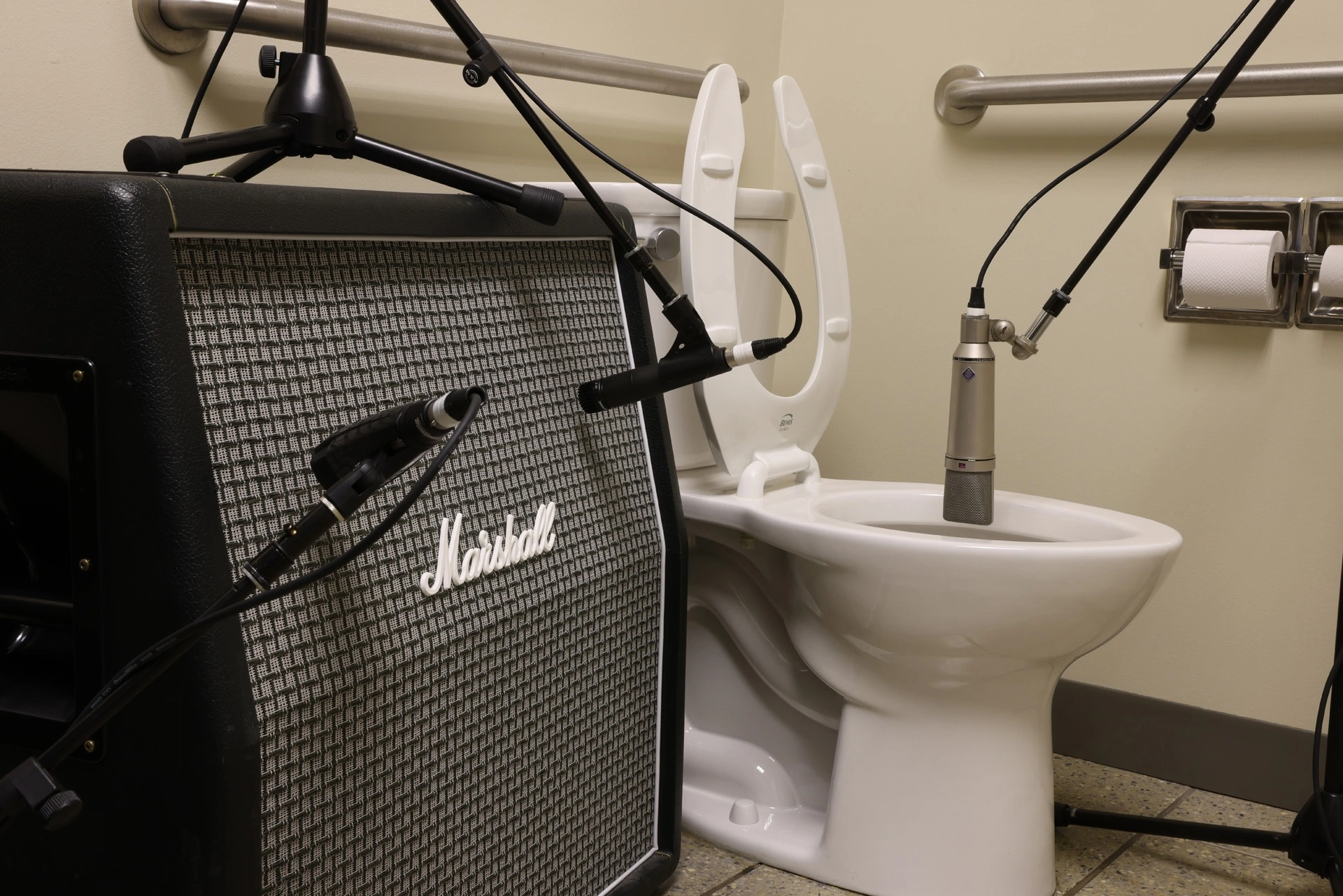

I think God's telling you where to set up for your next project :p:laughings:
