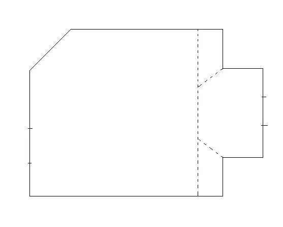

Hrm. Corners are going to be tough for me - I'll do something a bit more exact in Google Sketchup tonight, but this is roughly the floorplan, attached.
The dotted lines are where an angled wall meets the ceiling, and there's a little alcove with a window - the other side has a door. I could probably fit my desk in there, but somehow putting it intentionally in the smallest section of the room seems like a bad idea, somehow, so I've been thinking of putting my bed against the wall at the bottom, and setting my desk up on the far wall, centered, facing my bed.

Don't jam your desk into that little alcove. You'll want to be 30% of the way into the room anyhow, which will put you well back behind it anyway.
Wasn't planning on it - see above.
Also, 30% into the room is simply not going to happen. Again see above - this is first and foremost a bedroom that I'm acoustically treating to make it double a bit better is a studio. I COULD put a desk 30% into the room... but if I was to do so, I'd lose (including the desk) something like 50% of my floor space, and rooms in old Boston houses are small enough as it is.
It's theoretically correct, yes. It's also a practical impossibility.
