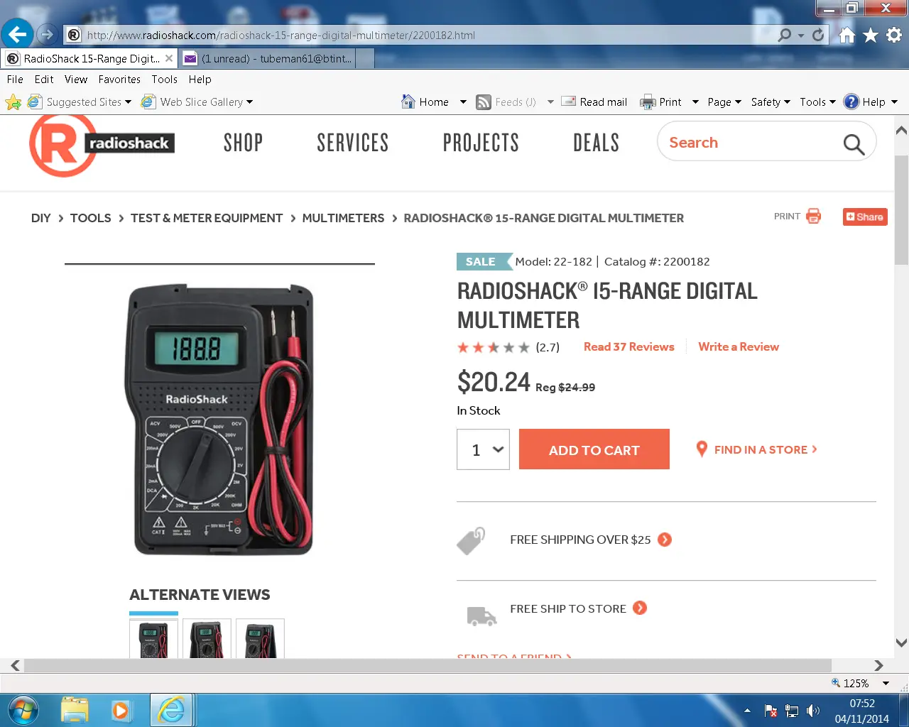

Since I and I am sure all the regulars here ar tired of me TYPING it!
Here I have attached a picture.
If you have a meter - then plug in the cable from the phantom power unit to the mic, but do NOT connect the mic, or the cable that goes to the interface - just the phantom box and the cable to the mic. with the phantom power unit switched off, connect your meter on the Ohms range between XLR 'holes' 2 and 3. You should see just over 13K Ohms. If you do, great - the cable is fine, if you don't, then pull out the cable and do the same test on the female socket on the PSU. If this then reads 13K or so, the cable is faulty. Next test, if this last one passed is to power up the phantom box, again - not connecting it to your interface. Put the cable going to the mic into the box again, and leave the end loose, as before. Put the meter onto XLR 'holes' 1 and 2, with the meter set to the volts range appropriate to 48V. Expect to get between 40 and 50V - it's unlikely you will find exactly 48V, this isn't a problem. If you get, say, 44V, then swap the test to 'hole's 1 and 3 and you should get exactly the same reading. If you don't, then repeat the test directly on the power supply box with the mic cable removed. If the voltages are exactly the same, then you have confirmed the PSU and cable are fine. This then leaves you with the conclusion that if a dynamic works on that connection, and the condenser doesn't - the condenser is faulty, as you will have proven the phantom power is at least getting there.

I'm leaning to a faulty phantom power unit. Does its Led glow when you turn it on? As Dave suggests, a multimeter would come in handy.
