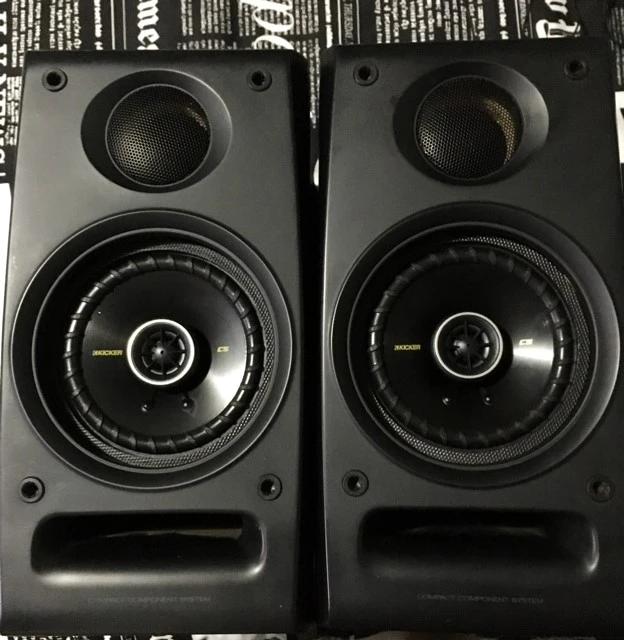

The long and short of it is I need to replace 2x front speakers. The pioneer boxes are sealed with no way of opening them.
I had old JVC boxes and I have purchased a pair of kicker 2 way 5.25" and fitted them in the JVC boxes and they look and sound awesome, I was going towards crisp highs and decent midrange as I mostly listen to Instrumentals and Youtube covers, guitars and pianos etc.
My concern is should I be worried about the amp melting down or blowing the speakers and is there any way I could correct this efficiently without losing sound quality??
Any assistance would be much appreciated, specs are below.
