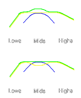

I'm a firm believer in "a picture is worth a thousand words" so I've attached a diagram to help illustrate. By "stereo bus" I mean you mix the guitars, keyboards, and backing vocals all down to one stereo channel, or save just those parts as a single stereo track which you're then going to mix back together with the lead vocals as well as the bass and drums.
In my diagram the yellow line represents the frequency spectrum of the guitars/keyboards/backing vocals mix and the blue line represents the frequency spectrum of the lead vocals (that digitech preset actually is, at least in part, an eq which emphasizes the midrange). The green line is the resultant spectrum when you mix the two together - yellow and blue makes green.:D The green is the end product so that's the one you worry about the most.
The top diagram illustrates what you basically have now - a bunch of midrange instruments added to a very midrange heavy vocal resulting in a mix with an even bigger, honkier midrange peak in the middle.
The bottom diagram illustrates what I've suggested that you do. When the lead vocals are present you use a filter to scoop out some of the mid section of the guitars/keyboards/backing vocals mix which corresponds to the spectrum of the lead vocals. The resultant mix then has a flat spectrum.
You can bring up the lows and highs when you mix in the bass, drums and maybe some added cymbals.
Make sense?

......great illustration by barefoot. That might very well be it. Here's some more options: I dont know anything about the d. vocal processor you have, and im sure youve been through all of the presets.... but on this song, were all of the presets that you tried kind of mid heavy? Does the unit have an eq on it, and have you experimented with the mid levels on it? How about gain?...just curious.
Regarding EQ, I have a naturally midrangy voice so I have to take some off at around 1k. Of course this varies depending on my mic chain, but I find that by doing this my voice tends to "sit" better. Here's what i would try: Bring up the mixer EQ on your vocal channel, and turn the mids all of the way down. Notice where the harshest tones seem to disappear the most as you adjust the mid freq. Then turn the mids all of the way up, and this time notice where the harsher tones seem to be most apparent. This will help you find what you need to cut. Im sorry, if im being redundant......just thinking out loud.:D
