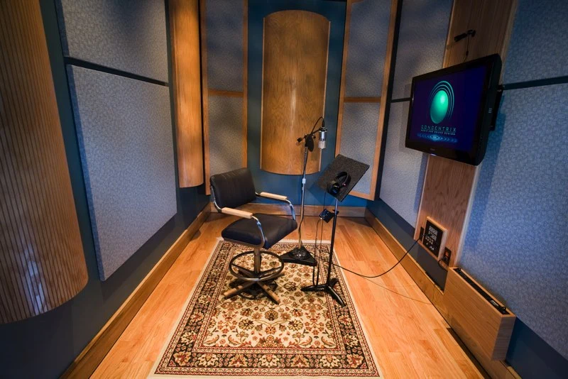

As to the 'vocal booth' idea. If you want to sound 'dead' when doing vocals go for it. :eek: Foam will suck up all the highs, and you'll find yourself trying to EQ them back into the mix. If you fully line the booth with proper trapping (4" thick) it can at least evenly absorb the audio frequencies. If you've got someone at the control desk while a second person is recording - the person at the desk should shut up, be quiet and listen with headphones, you shouldn't have to isolate the vocalist because the engineer is making noise!
That wall is 10' 2" (10 foot + 2 inches)... sorry the apostrophe indicating feet isn't super clear. So the difference in wall lengths is 1 foot 10 inches rather than almost 4 feet. In both of the studios I've recorded in that purport to have recorded some good local band CDs their rooms were pretty dead for vocal tracking. Yeah, they EQ things back in the way they want them but I thought the microphone would pick up all the frequencies (before they're reflected/absorbed) and then they can deal with post production EQ'ing and adding in the right amount of reverb depending on the track the vocals would be put in. Anyway, I'll have to do more research on that topic since you seem adamant that it shouldn't be that way.
Again: foam will absorb the highs, but leave the low-mids and lows to bounce around, creating muddy sound.
Have you ever seen a picture of a professional recording studio with a small closet-size foam-lined "vocal booth"? Maybe there's a reason you haven't. ;)

I believe you on the vocal booth thing... when I search "professional vocal recording booth" and look at the images section on bing or google I see everything that looks like a small closet type setup. Do you have a link to a picture of what you would consider the ideal vocal recording space (if I'm only recording vocals over already mixed tracks)?

Don't worry about 'ideal', instead figure out how to make your space work for you. Some people use those foam-and-metal-and-plastic reflection devices that mount around the mic. Until I got some treatment in my room, I used my largest room, set up near one end, and sang toward the longest dimension to prevent early relections from being picked up by the mic.
