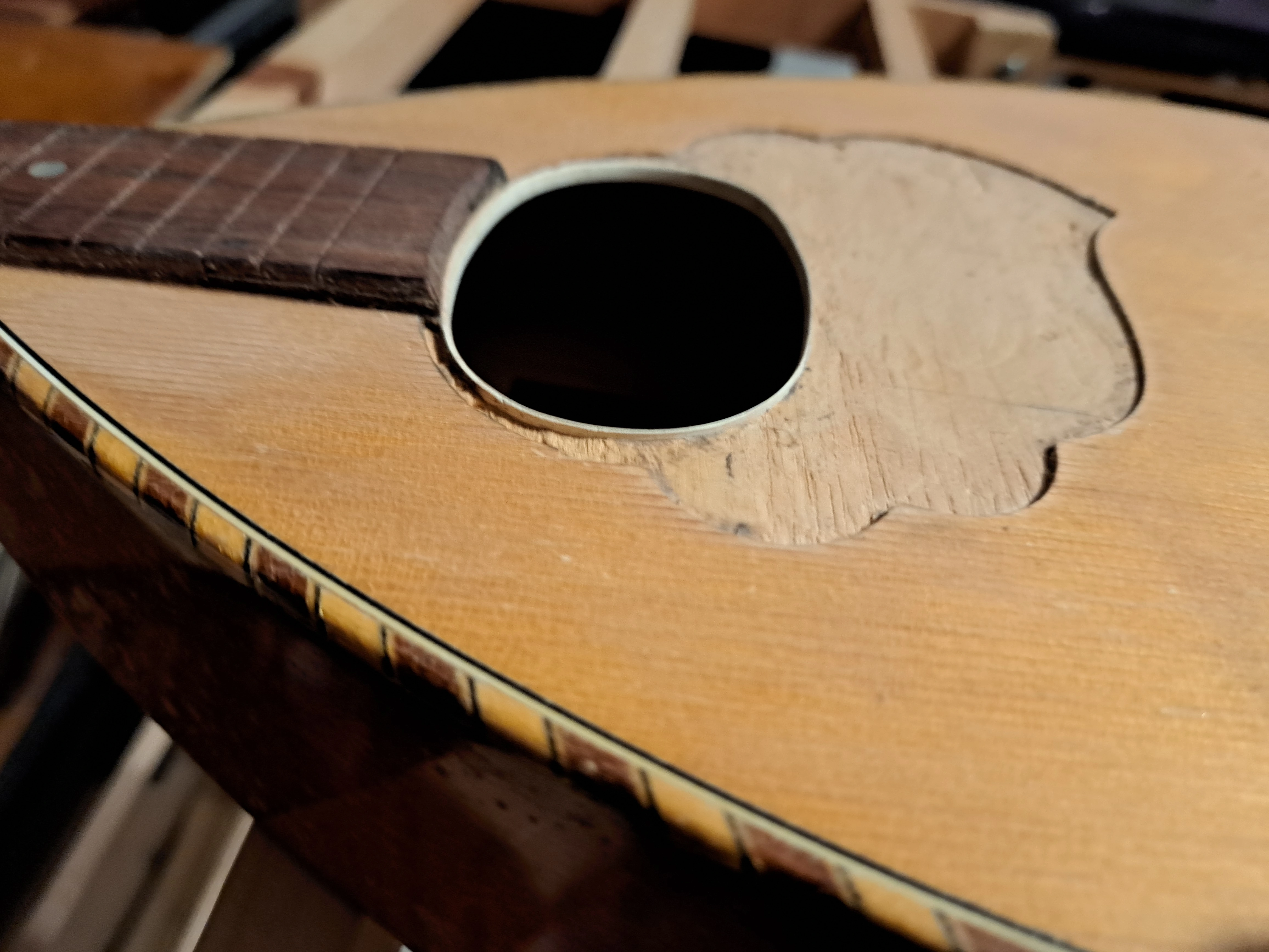

My Mando looks like this
You can reproduce the pickguard by first taping a thin piece of tracing paper over the top so it can’t move. Then using a pencil you can make a side to side motion with the pencil lead over the paper along the edge of the inlay cavity. This will leave a line that matches the pattern exactly. Then with scissors you can now cut the paper to make a template. Then transfer that pattern to your new .040” thick tortoise celluloid blank. That too can be cut with scissors but cut it a little proud and then use files or sanding blocks to shape it to fit.

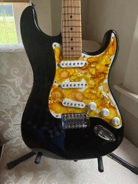

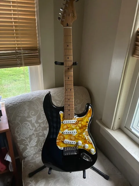

So, this one is finished.
Looks really nice to me. It's a very nice player. Noiseless. No hum and no buzz, But I think the 3 SD SSL-1s are just too flat for my taste.

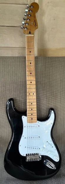

A Strat Player II MIM black body, and a Lindy Frailin Vintage Hot Strat set. Pre-wired.
I'll use the roasted maple neck from this one and replace it with a Mighty Mite ebony neck from another build.
