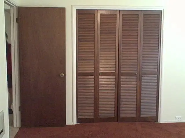

PIC #1. back wall with door open to the left and closet

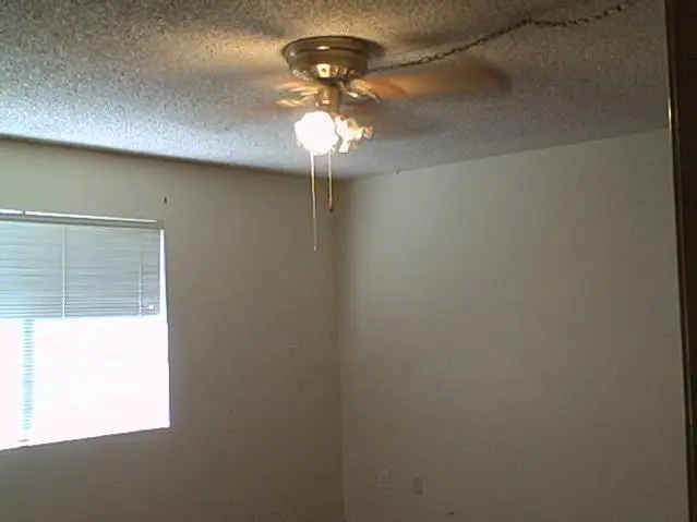

PIC #2. ceiling fan right above my mix position, slightly behind my head - where absorber should go?

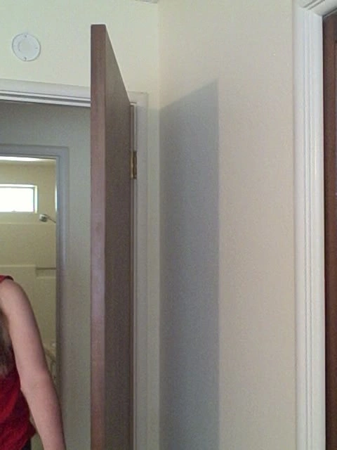

PIC #3. back corner with door open showing practically no room for bass trap

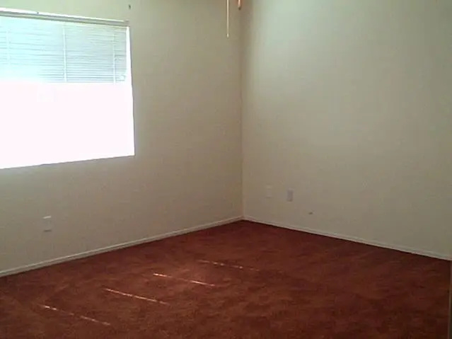

PIC #4. window opposite my left ear at mix position, how to hang absorber? (and is the window a problem? should it be covered?)

15 x 13 x 8 is not too bad - the room is 1560 cubic feet and above the minimum volume requirements. You will want to position yourself 68 1/2 inches from the front wall (mark a spot on the floor).
For placement of the ceiling cloud and side RFZ panels go here and get my First Reflection Calculator. You may find that the ceiling cloud will be placed forward enough to miss the fan. ;)
The panel that needs to be in front of the window can be built on a stand or hung on wires. The GIK monster trap can be hung in front of the closet doors or even place inside where it will still be effective. The difference with the trap being inside or out of the closet is that you will get unwelcome reflections from the louvers on the doors with the doors closed.
Traps don't necessarily need to go in vertical corners. Horizontal corners do just as well, like the wall/ceiling corner and/or the wall/floor corners.
Once you get the GIK kit installed you should test your room and add and/or move treatment as necessary. Good luck and keep us posted.

As far as the closet doors go, I'll have things like microphones and other relatively hard surface items stored in there so I'd need to keep the doors closed when recording or mixing. Maybe I could get a stand for the Gik Monster Trap and place it in FRONT of the closet doors. This way I could move the trap when I need to access something from inside the closet. Making it portable might be useful for other things also like maybe for placing the trap near a vocal mic.

Glenn (from GIK) said something similar in reference to the corner behind the door. He said to either put 2 panels in the back open corner or straddle an 'upper ceiling to wall' corner.
By straddling an 'upper ceiling to wall' corner, I think he means to put a bass trap (or some kind of wedge) across ceiling/wall corner right above the door.
Thanks again,
Jimmi:)
Exactly right.
