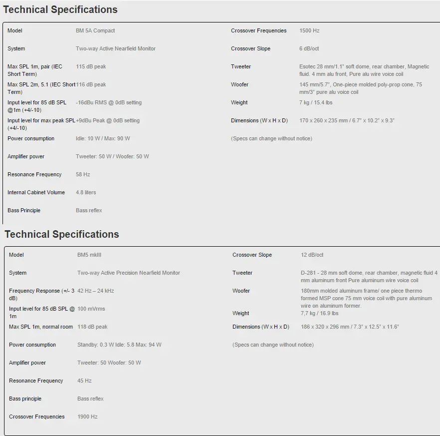

I had a bit of a look over the spec sheets, and did a bit of reading.
The general differences are that the Compact model is aimed at film/video/broadcast post production studios, rather than music recording studios.
From what I've read the two models are voiced differently, and the cabinet resonance is 3hz different on the spec sheets (58hz vs 55hz).
They should be very similar in almost every respect from a technical POV - same amps and cones used, but a slightly different voicing. Still should be very nice to work with in the studio, I used to work somewhere with bm5a mkii's and they were crisp and clear enough for me with my taste for slightly forensic monitoring.
I didnt know they had added the compact..
The specs:
