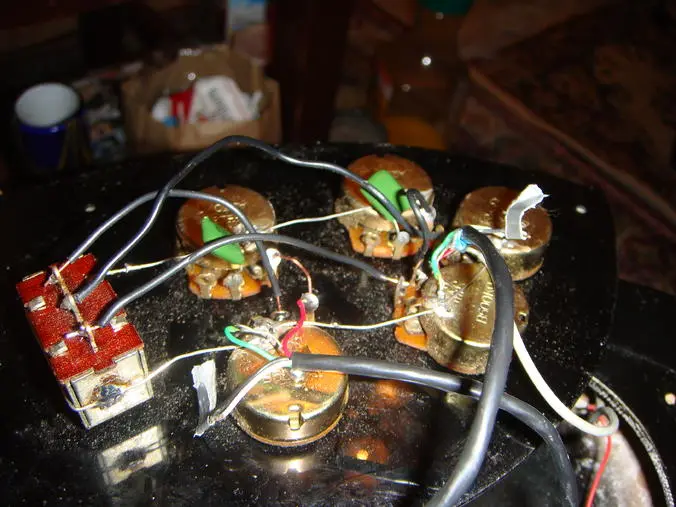

OK! Look I re-wired it!! Now the volume knobs and the tone knobs do their job. And the blender switch is still the master volume. But it probably cuts alot more of the highs than it used to, running through 5 pots instead of one like before. If I replace them to all 1 meg pots, will that be totally fixed? I already bought the 500Ks.
Still want to make the small knob a blender/mixer knob instead of a master volume. Anyone know how to do this??
Here's a pic of the new wiring. Thanks Danw for replying and givin those links. I had no idea how to do this before.

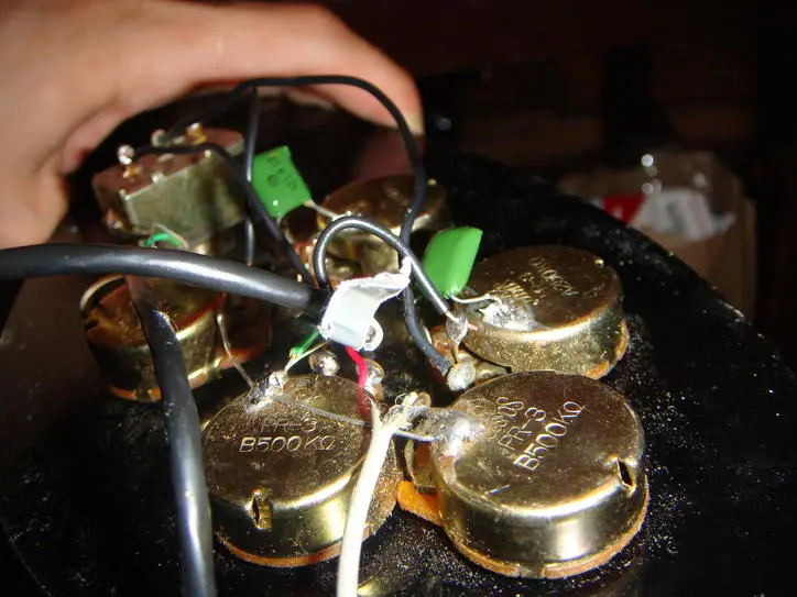

will changing the pots get rid of the noise and cutting out when I turn the knobs? The bridge tone knob does it too.

To get the fader pot to do it's job, you are going to need a different type of pot. It needs to have a dual action, like a pan control or stereo balance control. A single action pot explains why it only works as a master volume. Your pups may be wired more like DiMargio pups so you may want to check some of their wiring diagrams too. The adjustment screws on the pups are supposed to allow you to adjust for the difference in height (make the distance from pup to string more even) due to the arch of the bridge/fingerboard. It probably wont make a lot of difference so don't worry too much about it.
Ok, there are a few things troubling me about this setup that I haven't been able to figure out. As far as I can tell, a blend pot looks like it's just two pots on the same shaft, whose sweeps travel in opposite directions, so that both volumes are all the way up when the knob is at its center position. That's why the six lugs. What I can't figure out is how to wire that in where it won't just be redudant with your other volume controls. You could put it in between the pickups and the selector switch:
and I think it would function as it's supposed to when both pickups are on. However, it would also affect the sounds of each pickup on its individual setting. For example, if you had the blend knob turned entirely in favor of the bridge pickup, when you switched to the neck, you'd get no sound. Is this how it's supposed to work? I've never owned a Ric (real or cloned) so I don't know if that's the intended function. That seems redundant with the existing volume controls to me. I can see having it instead of a selector switch, or in combination with a master volume instead of individual controls, but in this configuration it doesn't make any sense to me.
Furthermore, I don't see in the Ric diagram where they're using a blend pot at all. The thing they're calling "mixer" doesn't have enough wires going to it. It looks like a regular pot that sends some of the output from the neck pickup past the tone control.
By the way, the bare wire coming out of the pickup wire is a shield, which you'll want to connect to ground if you haven't already. Shielding is used to combat hum and keep things like nearby radio stations from coming in through your guitar.
If you've got scratchy sounds when you turn the knobs, yes, replacing the pots should take care of that.

I just rewired it so the volume control is indipendant on the middle switch. I have a special blender pot comming in the mail. still dunno how to wire it up. do you mean that 5 wires are more like dimargio pick=ups??
I was thinking that the dimarzio comment was more likely to mean that the wire colors may be different than represented on the SD diagram. Like I usually see the red and white wires soldered together, but I think in the first picture you posted it was the black and white wires.

Since you're not separating the coils in any way, wiring humbucker pickups is no different than wiring single coils. For single coils, people typically use 250K pots, and 500K for humbuckers, but even that's a matter of preference.
By run the signal through a cap, I mean put a cap in between two of the components that currently have a wire between them. Like to run the whole signal through a cap, where the wire runs from the jack to that
master volume control, just put a capacitor in between the volume control and the wire instead of hooking it up directly. I'm pretty sure what you'll get is a thin, clock-radio sounding guitar.
Here's another idea you could try, though. Seems like the extra bass response is bugging you pretty good. Instead of a blend to blend the two pickups, suppose you use that blend pot to make a variable bass cut. I think this would do it:
The circle is a capacitor. At one end of the sweep, the signal is normal. At the other end, it's all clock-radio. The places in between might be interesting combinations of the two, especially in combination with the tone knobs. I don't know if it would work, but it could be interesting to try. The only problem I foresee would be a slight weakening of the signal.
