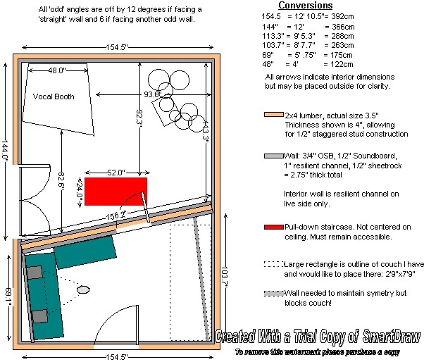

Need Critique of Garage Floorplan
  • Thread starter Thread starter ap
A
ap
Member
Where's that begging on knees message icon...
Starting with a 20X14 stand-alone garage w/ unfinished interior. Going for similar to the 'Garage 2' plan on the SAE site. There is a pull-down staircase almost in the center of the ceiling which must remain accessible, and french doors on a long wall, which could be obstucted, but not by something permanent, like, say... a wall!
Must haves:
  • Live recording room. Ok, this is obvious. I just mention it to indicate I would like to do more than just mix.
  • Vocal booth
Like to have:
  • Control room to monitor signals real-time w/o also hearing source. Not necessarily have to be same room as for mixing, but I guess if it's not a good mix room, it's not a good monitor room?
  • good sounding mix room
  • A couch.
  • Drum isolation room. I have an alternate plan with combo drum/vocal booth, but I started thinking the live room became too small. Maybe I'll put it up after I get some feedback on this one.
Does this garage have a chance for anything other than a practice space? Should the spaces be switched: recording in the smaller space, control in the bigger

Looks good ap. Yes - I'd consider swapping the rooms. It depends on what you intend to record. Many musicians now prefer to be in the control room with their amp in another room. All the action is nowadays taking place in the control room.

Thanks for checkin it out.

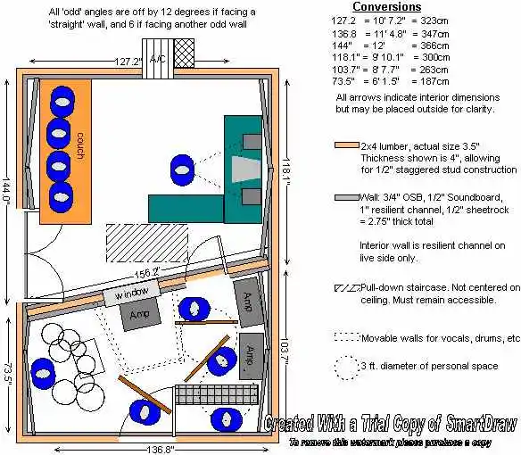

changes
Thanks Tim. Not a bad idea, but putting an amp up there wouldn't help enough, I don't think.
I've mainly got two things on my mind: which room to use for control, and do I really want to angle the short walls.
I've made improved drawings, and will try to delete the image in the first post as it is now redundant. This jpeg has two designs: one w/ control in small room, and one with control in big room.
Control in small room advantages
  • more room in full band situation
  • better view of live room
  • couch doesn't block french door. This is minor though, that's the stationary door, and the couch can always be moved if necessary.
Control in small room disadvantages
  • small control room
  • difficult to soundproof live room w/ a/c in it
  • bigger live room means harder to make room within a room
Angles
Man, it's depressing how much space you lose angling the walls 12 degrees. Any idea how bad it'd be to treat if the short walls were parallel? Definitely angle? Maybe? Doesn't make much difference acoustically?
One good thing about angling is it means you don't loose as much space when using double wall construction since you're already off the first wall anyway.
Any and all opinions/comments/experiences on the preceding are greatly appeciated.

I tend to go for the second one with the large control room but I appreciate your space for rehearsal etc. What if the players are in the control room (except the drummer) and you divide the other room into a drum room and amp room. Then you can all lounge around listening to your monitors wound up :)

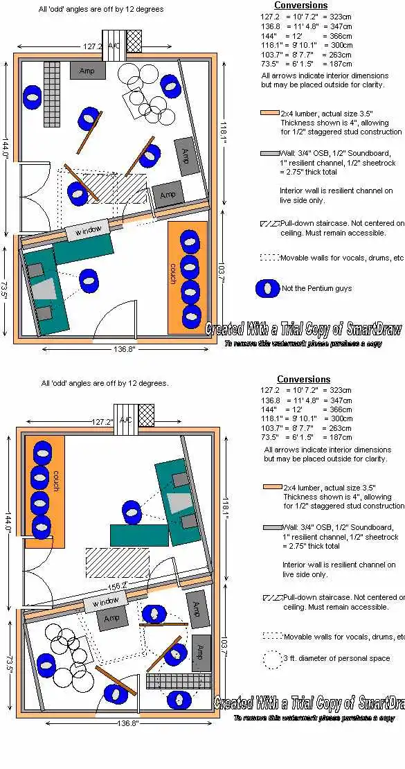

Sounds like a perfectly great idea to me. John, I assume you think this would work well. Does anyone else have an opinion? I wonder if many people would have trouble not 'feeling' the drums or their amps. I'll work up a drawing. Damn, I love Smartdraw! This is sooo easy!
In the meantime, check out this drawing with facing 6 degree wall angles that achieve 12 degrees w/o coming into the room so much. I like it much better. For now, I've only done it for the big control room since I'm starting to lean that way.
