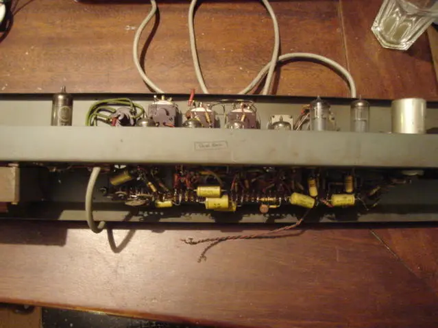

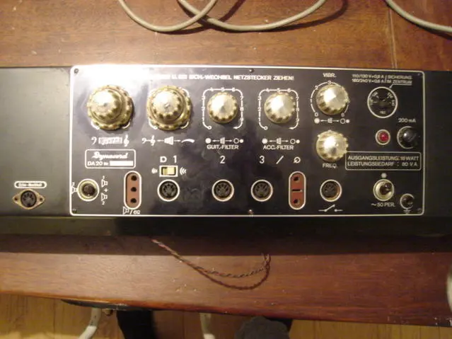

I got this 1961 Dynacord DA-20 Guitar amp through a trade deal a while back. The woman who had it, had bought in some auction, but never used it because she couldn't plug in... all DIN inserts :confused:
Now, sorting out the DIN inputs are a piece of cake. But when I turn the amp on it starts smoking. Surely it's just the dust burning up. Any tips on cleaning the inside? I thought water and washing up liquid wouldn't be the way to guy.
Some tips on the tubes would be nice too. Right now what's in it are (right to left): Valvo Ez 81, Valvo Ecc 83, Valvo Ecc 83, Telefunken Ecc 83, Telefunken Ecf 80, Telefunken El 84, Telefunken, El 84. That seems like a slightly odd collection to me. They're all a bit dirty, but not burned out.
Any tips on where to start? Anybody?
I'm sure you'll all say: "plug it in and sort it out", but the smoke thing has me lifting an eyebrow or two.

Well the shock advice was too late, not that I got shocked, but I had allready fingered the whole thing. I've been shocked before, you get used to it.
But thanks for the brush advice, that worked a bit, though it's really cacked on here and there. Could use some more tips there.
Thanks for the tube info too. I'll look into that some more. Is it a good idea to replace the tubes? For which ones?
I think the picture in the link is exactly my amp. The way the insides of the top is bracketed into a housing that doesn't entirely seem to fit makes me think it's a home made yob
