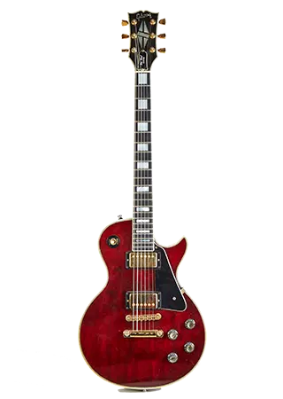

We recently had 1 78 LP Custom which was refretted:
After the refret, each fret position on the binding had a tiny crack. Not something that you would see easily or feel, but you could find them if you looked carefully.
To get the special refret Jimi has already mentioned, you need to spend $600-1K. So the guitar is only worth $3-4K max, so preserving the original nature of the guitar is only something you would do if it is a family heirloom guitar.
My advice would be to try a few different Les Pauls and see if you like the feel of the frets over the binding. Otherwise, keep the binding up high.
I would never shave the binding down and put the frets over the top with the angled edges like a Standard. It devalues the guitar and makes it look like the refret was not done properly.

As to 'cracks' the binding, that isn't a sure sign of a refret. They can occur on their own as a result of the wood swelling and shrinking. The fingerboard shrinks, the ends of the tangs are poking at the binding.....crack. wood expands and cracks, metal.....not so much. Binding plastic can get brittle. Lot of stuff going on there.
It happens. :D
[MENTION=3102]Maclazine[/MENTION] That's a beautiful custom :thumbs up:
