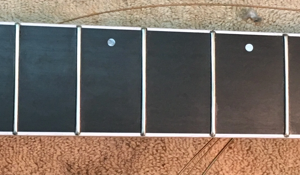

With regard to the binding, if you want to keep the value of the guitar, dont break the binding on the edges of the frets. An expert luthier can refret without breaking the binding, but as the frets are extracted, you get small cracks in the binding at each fret. This is a common way to pick refretting.
We recently had 1 78 LP Custom which was refretted:
After the refret, each fret position on the binding had a tiny crack. Not something that you would see easily or feel, but you could find them if you looked carefully.
To get the special refret Jimi has already mentioned, you need to spend $600-1K. So the guitar is only worth $3-4K max, so preserving the original nature of the guitar is only something you would do if it is a family heirloom guitar.
My advice would be to try a few different Les Pauls and see if you like the feel of the frets over the binding. Otherwise, keep the binding up high.
I would never shave the binding down and put the frets over the top with the angled edges like a Standard. It devalues the guitar and makes it look like the refret was not done properly.
