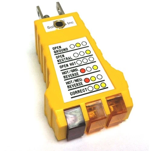

Get one of these and test all of your receptacles.
:thumbs up:
One of the best little tools for checking AC wiring.
When I got my current place, before anything else, I went around and checked EVERY receptacle for correct wiring with one of those testers, and also I opened every switch & receptacle and tightened down the screws holding the wires.
For any that had/used the wire insert holes to grip the wires (the cheap-n-easy way to install), I took out the wires and instead used the screw-on connections.
If you have a loose wire, even a little loose, it might not cause hum...but it can cause noise/pops/clicks every time power is run on that line because it can arc, which pollutes your entire AC.
Apartments are a bit trickier, because you can only check so far, and not through the whole building....but still, check anyway.
