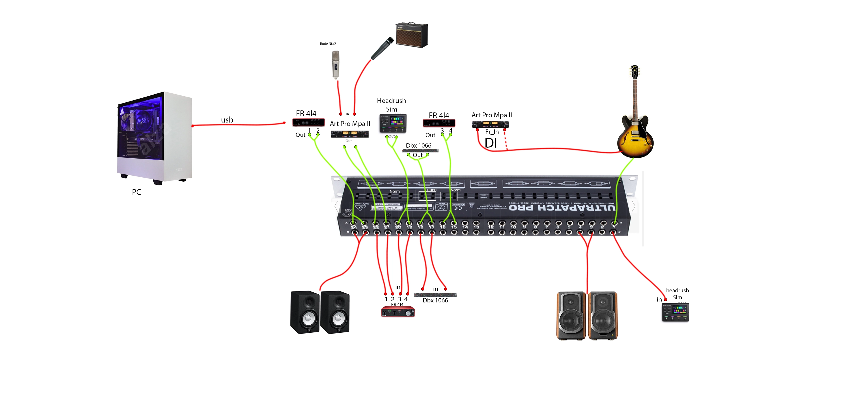

Just for Clarifying diagram shows only one Interface, one preamp, one sim, and one compressor.
i have separate only inputs and outputs.

Your diagram is a little confusing. Each component should only be shown one time, with all its connections then shown.
From your description, it sounds like the feedback loop is the ch 1/2 input going to the output 3/4. Have you looked at the Focusrite mixer software?
You are right. ill edit the text.
