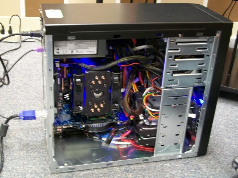

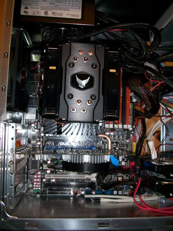

That CPU fan is frikkin massive!!!
very nice build. What's your break down of parts?
I hope you have an iso box or plan on running it far away form any decent qality micsI'm always worried that bolting that much weight in a heat sink and fan onto the motherboard would bend and distort it! Especially as the part of the board it is hanging off gets hottest.

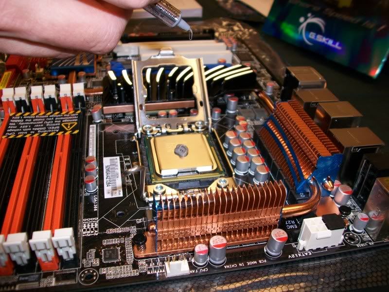

the asus is awesome....it has the look and appeal for a clear case as well as the engineering aspect that is far above par. the cooling system on the board is pretty sweet...with the copper piping and the black and silver fins direct air to your pci cards. It booted up no problem...and asus put this quick boot type feature with this board. So without having an OS installed you can go straight to the internet, using this quick start. The thing i like about this board was the outputs it provided, with the spdif, optical and surround ports.
the heat sink I bought came with a pretty bulky retention plate for mounting and spreading the weight around....We'll see how it holds up. I just got half of my studio equipment in today and i'm still waiting on the main peice, my Digi 003+ and Pro Tools 8. I can't wait to see what this thing is capable of.
