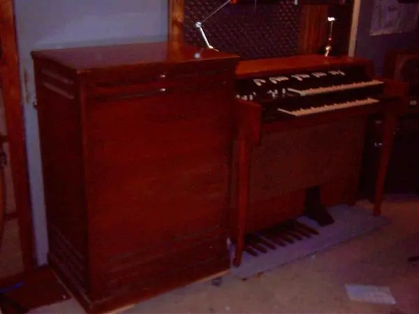

Finally, I have my $10 Hammond L-103 and Leslie 147 (the Leslie was around $200) fully functional and tied together. I worked a LONG time on the tone wheel assembly (think about the insides of an overgrown Swiss watch) with Hammond oil and re-capped the B+ supply on the amp. I already had the Leslie and the Combo Preamp/six pin cable but that won't connect a Hammond to a Leslie. I looked around at a local Hammond dealer for a six pin Amphenol connector for the organ side but had no luck so I took two male and two female 11 pin tube sockets I had and "leached" them onto the Hammond and Leslie (plus a switch on the Hammond to toggle between the internal speakers and the Leslie) and used two sections of a heavy duty extention cord for the six conductor cable. What can I say, it works. I've also done a few modes on the Hammond's preamp to get more B-3 chirp and I'm contmplating the fold back mod for the highest draw bars. But here they are.

At last! A sympathy post! Bless you Craig.
Nice rig. I finally scored a rebuilt tube 147 for significantly more but it sounds great in our dome room. I need to find a decent deal on an organ now. I'm just using a Yamaha SE90 through a blues driver pedal.
Dude! The store I tuned pianos at in Baton Rouge was a major Hammond repair place so I know exactly how much work you must have put into that!
Did you have to fool with the wiring harness or was it all still in good shape?

Bob; If I do the fold back mod, it will require pulling both manuals which means unsoldering the harness:eek:. The only thing stopping me at this point is it requires a spare manual to use as parts. If I had that, I'd be sniffing melting solder right now. The mods I did on the preamp gave it more key click and chirp which makes it a LITTLE closer to a B-3.
JMorris; As I'm sure you already know, all the L-s are electronicly the same, the number following it just refere to the cabinet style so we have the same organ (that sounds just wrong).
Lectric_Lab; I put it (and the Leslie) on a wheeled platform to roll around the studio. I was in a band with a guy who played with a C-3 and 147. Four of us could barely move it. I wouldn't gig with it but I'd haul it to select venues. This sum bitch is HEAVY. I've had synths (Ensonique VFX and Alesis QS-8) that would do what I thought were decent Hammond emulations but after playing with the drawbars on the real thing, I realized how much the synths wouldn't do. This thing is friggin' cool.
