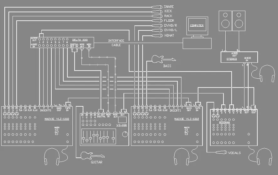

I've been recording my own original stuff for a while now, but it's always been one instrument at a time. My friend's band is coming over tomorrow to see what I can do for them. I'm planning to record live drums/bass, and maybe one guitar simultaneously. Bass and guitar direct. I'd like to have the vocalist sing while recording the three instruments, for a guide, but dub him in afterwards. I can also put him outside the room.
My plan is for everyone (including myself) to be wearing headphones. I should be able to tap my 3 mixers, my receiver and my tape deck (not shown).
I've attached a diagram of my home studio setup. I've got an opportunity to make some $$ here, so any suggestions about wiring/monitoring, etc. are welcome.
I hope the diagram is clear. Let me know.

Looks tight. I assume the bass gtr will hit some kind of a preamp on the way into the mackie (your 'mic input' graphic means lo-z input right?).
Did you actually draw all the little knobs by hand??? ;)
Very impressive diagram!I wish I could do graphics as nicely.

Looks pretty good. I would consider that direct Roland guitar a scratch track. You will probably get a better sound micing his amp with a 57.
The bass should be fine going into the mackie mic pre if the cable run isnt too long.
You dont mention 2 of the most important things. Your mics and your monitors.

Heinz, I did the graphic in AutoCad, then output the screen shot to a gif - design is my day gig...
Tom, the band is actually pretty tight. They play together often and play out at least once a month. I'm pretty comfortable with drum recording these days as it's been my main focus for the last five or six months. I like your 30-second sound check idea.
Tex, I'm probably going to run the guitar through my J-Station, which will allow me to use its digital out to go to the Delta digital in. I'm sure they'll want to dub the guitar later. Also, I want to avoid bleed and micing the guitar and drums in the same room will probably be a problem.
