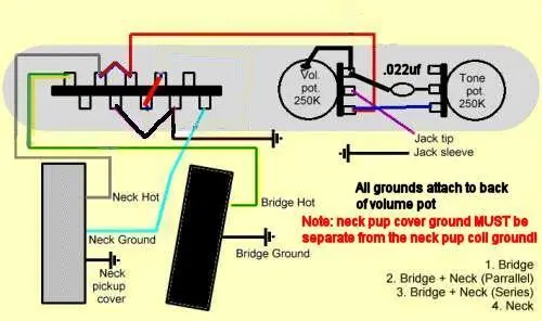

That concentric pot looks great, but I bet you will need to rout the control cavity a little deeper to make room for it....isn't the contol panel on backward also? Is that to avoid hitting the 3 way switch by accident or just to give easy access to the tone knob?
A 4 way switch is a great addition to a Tele as well, and the wiring diagram below will allow the 2 combined pickups together on the 2nd and 3rd positions and the bridge and neck pickups on 1 and 4. I find that combination works much better that the standard wiring for a 4 way!:)

Yes, I flipped it around for that very purpose. (And had to rewire since everything was in there nice and neat and just the right length. I also like to roll the volume knob with my pinky and put it forward to help with that. Thanks for the four way diagram. I have printed it (If that's OK.) and am studying it over coffee this morning.
No problem, use it. I found that schematic on the Tele Tech section of the Tele Discussion forum, there is an amazing amount of info and knowledgable people on that site. Check it out, heres a link-
