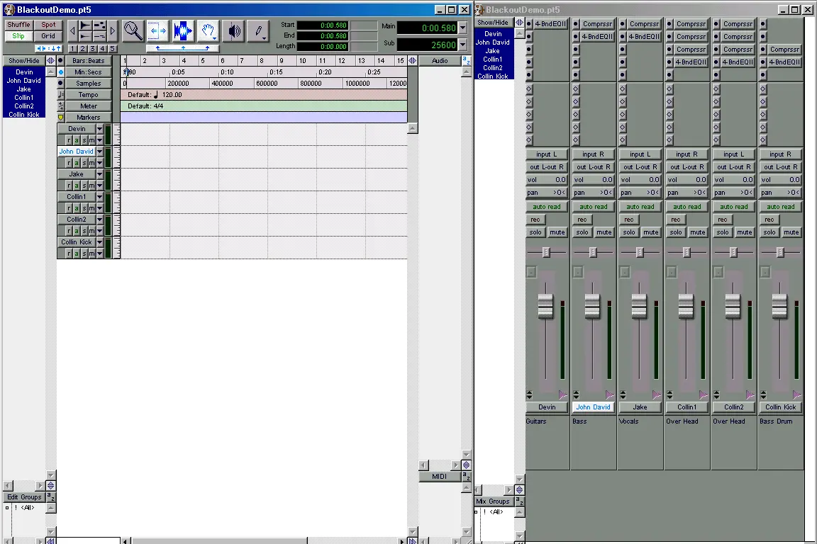

well heres how i got it set up in pro tools
I think you kinda' got it a little backwards.
The drums should be tracked before anything else. It sounds like a good idea to record a scratch and play along with that, but the drummer should be the first to do so (unless you are using a click track, that is).
If you have to, just blair the guitar and bass on your scratch take.
well what i did was. just lined my guitarist right into the sound board. ran head phones out of his track to the drummer. recorded the drummers tracks on track 678. so now i have alll the drums recorded and were adding guitar bass and vocals this weekend

k well im gona mix and compress everything into protools this weekend and ill post an mp3 or 8 :) and see how it came out!
