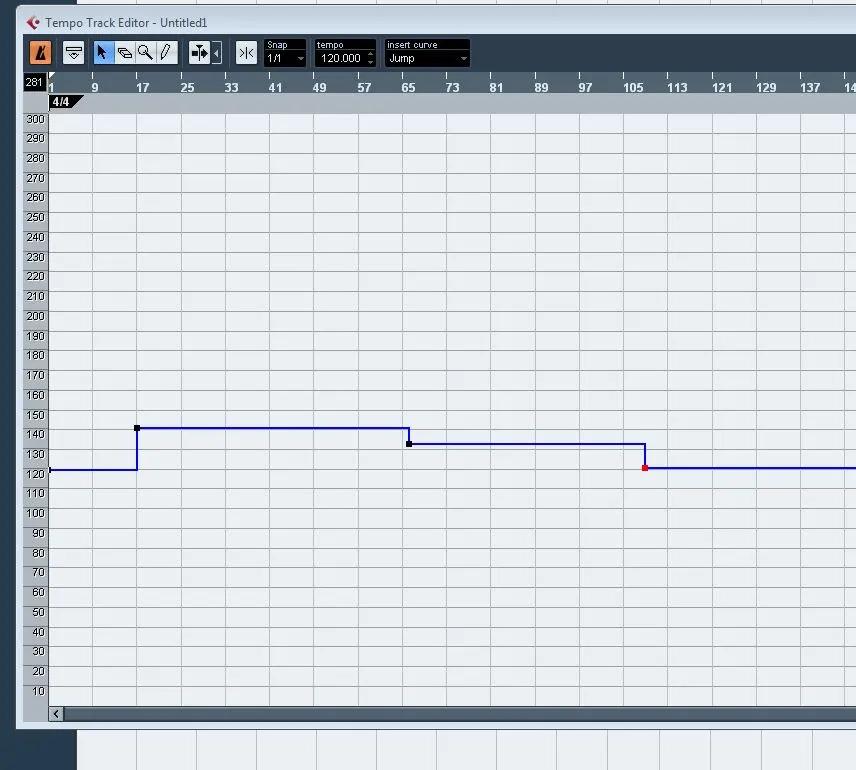

Yes, it will have a Tempo Editor on the LE version. At least LE5 does. I assume LE7 will as well.
It will look like this:

Thanks. Imma gonna try the Cubase. The image you included was very helpful.
