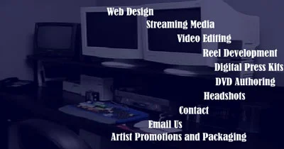

brad, my wigga... is it an NTSC studio monitor or is it just a tv? NTSC monitors have btter shielding, and shouldnt give you a problem unless the NTSC monitor is damn near against the computer monitor..
just stash something in between the TV and the computer screen, its the easiest way..
as far as it doing damage, my partner the idiot has his NTSC monitor on a stand 3 inches to the left of one of his computer monitors, and the screen shimmies a bit... hes used it like that for everyday the past 3 months, and there hasnt been any problems.. when you turn the ntsc monitor off the problem goes away.
ps..attached is a pic of my set up with an ntsc monitor, and i dont have any problems.. look past the letters..
- eddie -
forgot to attach the picture!!
