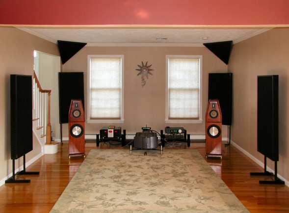

My understanding is if they are in optimum places, just like if they were fixed, it should be just fine. I believe I have seen bass traps mounted on stands in pictures, researching this myself.
Exactly. Most of this guy's bass traps are on stands, and they work exactly the same as if they were permanently mounted on the walls.
--Ethan
Thanks Ethan!
I appreciate the photo, it is very similar to what i was considering.
