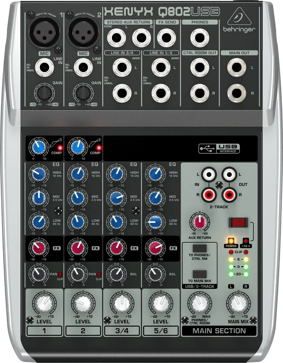

Hey everyone,
First post here and really the first post ever when it comes to audio recording. My setup consists of a condenser mic and mixer Xenyx Q802USB and a computer. What I'm recording or streaming is game audio, my mic and possibly voice software such as Teamspeak/Discord/Skype or similar.
The way I have it set up today is the mixer takes the mic on channel 1 and that is pretty much it. I do use headphones out of the mixer, so all I can do right now is control my mic volume and the audio level going to my headphones. Overkill with a mixer perhaps, but I want more now :)
If possible, I would like to be able to control game volume and perhaps voice software volume on the mixer, without it mixing with my microphone input. I just want the audio from my game and voice software to come out of my computer, into the mixer and only go to my headphones while my microphone sound still goes into the computer.
Would this be possible? And if so, how?
My Q802USB have two mic inputs, and two stereo inputs (Channel 3/4 and Channel 5/6).
I'm thinking.. If I can get the game audio out on a separate sound card or in some other way, get it out and plug it into channel 3/4 and do the same for voice software, get it out of the computer somehow and plug that into channel 5/6. Would it be possible to route those two channels to my headphones and be able to control the volume and EQ without those two channels mixing into my microphone audio that goes into my computer? Getting two cheap sound cards won't be a problem for sure, if only I get to listen to the output of them ;)
The output audio of the game and voice software on the computer will be recorded on the computer, so I will have the best quality recorded still. But if I get a little less quality out my headphones, just so I can control the volume on those two audio outputs into my headphones without having to do it in Windows, that would be perfectly fine.
Attaching an image of the mixer so you tech guys, who doesn't have this simple and cheap ;) mixer might get an idea on how to solve my problems, if it at all is possible. :)
Many thanks in advance!

If you want more than a single stereo track to be recorded, then you're going to need an audio interface with at least that many output channels. USB mixers in general are only capable of outputting 2 channels (a single stereo channel, which is L + R). There may be some exceptions but I can't think of any USB mixers that will output multiple channels. It is, after all, a mixer...it mixes sounds together :)
So what you're wanting is mic (mono), game (stereo), voice (mono), music (stereo). So that's 6 channels (assuming that mic and voice are two different things?). So you'll need an audio interface with at least 6 output channels.
Alright, sounds fair! However, I do not want to mix anything with my mic channel. So with the Q802USB I can only mix together every input into that 2 channel (single stereo channel) input to my computer?
So, I can't have my mic input going into my computer separate from channel 3/4 and 5/6 that only goes to my headphones?
I mean, no matter what kind of sources I have except the mic.. I want the mic to go into my computer over USB and channel 3/4 and 5/6 to my headphones, that's not possible with this product?

Hmmm, I'll have to think about that and take a look at the manual for the Xenyx. There is probably a way to get a signal to the headphones but not the 2-channel USB output. With these little single-bus mixers, you have to get creative sometimes. Larger mixers with multiple buses make it easy to do such things, but it should be possible with this little guy. Maybe by either using the channel inserts or the aux send/return in a creative manner.
I'll see what I can come up with when I have time this afternoon.

I see, well I watched some videos of mix minus for using it with for example skype and such. I haven't really figured that out, haven't tried connecting anything yet or so, but that should work.. well at least for one audio source through the FX Send port.
Then if I don't turn up the FX knob on my mic channel, it wouldn't go into the computer again and only to the headphones.. Or something like that, I have to rewatch the videos today and see if I can figure it out completely.
That however is only for one audio source, it would be nice with two as I have those two "extra" channels 3/4 and 5/6. Of course, If that is possible. As you say, it is a mixer.. so it should mix all sources together, but perhaps there is a way to not mix 3/4 and 5/6 into channel 1 and only have 1 into the computer and 3/4 and 5/6 to the headphones..
If its only possible with some sort of FX Send thingie, then I could route the game audio though that, because that's the most annoying one that could overpower all voice chat without any problems ;) So that's the one I really want to be able to control on a hardware knob, instead of going into the game settings and lower it down there.
I'm a little bit scared too, because I don't just want to hook cables up and try it out, as with any electrical device you could short out and in this case with a mixer, get a loop going that kills the electronics inside.. So I'm a bit careful with that :D
