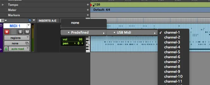

So I bought a USB to midi cable to record my electronic drums in Pro Tools.
I managed to track something and get some input but can't set the output to my built-in speakers so I can hear the playback of the track.
This is how the output bit looks when I try and set it to my speakers but it doesn't give me the option.
I don't have a MIDI port on my audio interface so I plug the USB straight into the back of my mac
Any help would be much appreciated!
Thanks!
Luke
Midi is a control signal, not audio. You need to have a VSTi - a virtual instrument - loaded into the track that will be driven by those recorded MIDI signals.
Oh yeah of course! How do I load one into the track? Not sure if there any drum ones on pro-tools is there?
Thanks!
Sorry, I don't know Pro Tools, but you probably need to buy one if you don't have one, like Addictive Drums, EZ Drummer, etc.
