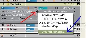

Sure...
Click on the MIDI out of the track, and select Drum Map Manager...
