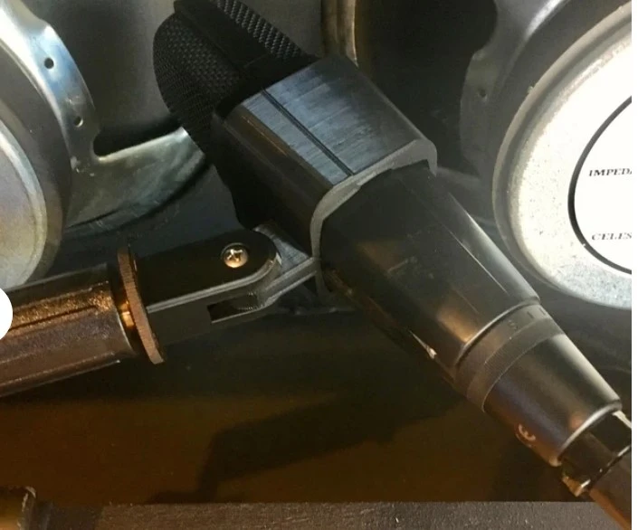

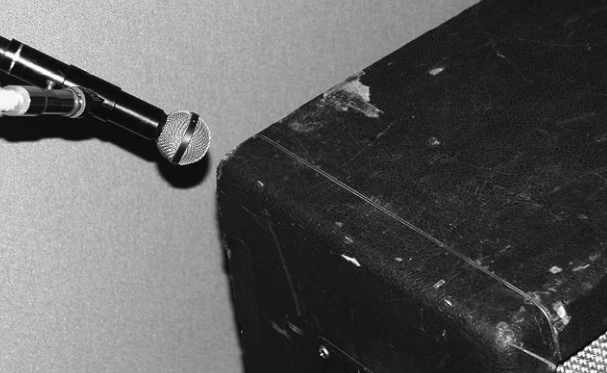

Microphones aren't ears, and you don't have your ears pointing directly at the speaker cone, so the mic will never sound like what you perceive in the room. (especially if it is close mic'd) If you put your ear where you placed your mic, you would hear something more what the mic is giving you. (don't do this at war volume)
The fastest way to get a good sound recorded is to let go of what the amp sounds like in the room and focus on what it sounds like to the microphone. If what you are getting in the mic is too dull, aim the mic more toward the center of the cone, if it is too bright move it away from the center. Small mic movements make a huge difference in the captured tone.
