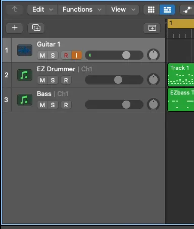

Hi! I'm having difficulty getting the signal from my microphone in to Logic Pro. I'm using a Behringer UMC22. I can see the signal getting in to the the sound card (UMC22), but the signal is not getting in to Logic. I made sure in the audio settings that the UMC22 Is chosen as input/output. then I press the record button but the signal doesn't appear...?
What am I missing....?
Thankful for help,Deeno.
Have you checked 'Input Monitoring’? It’s the ‘I’ on the channel strip.
