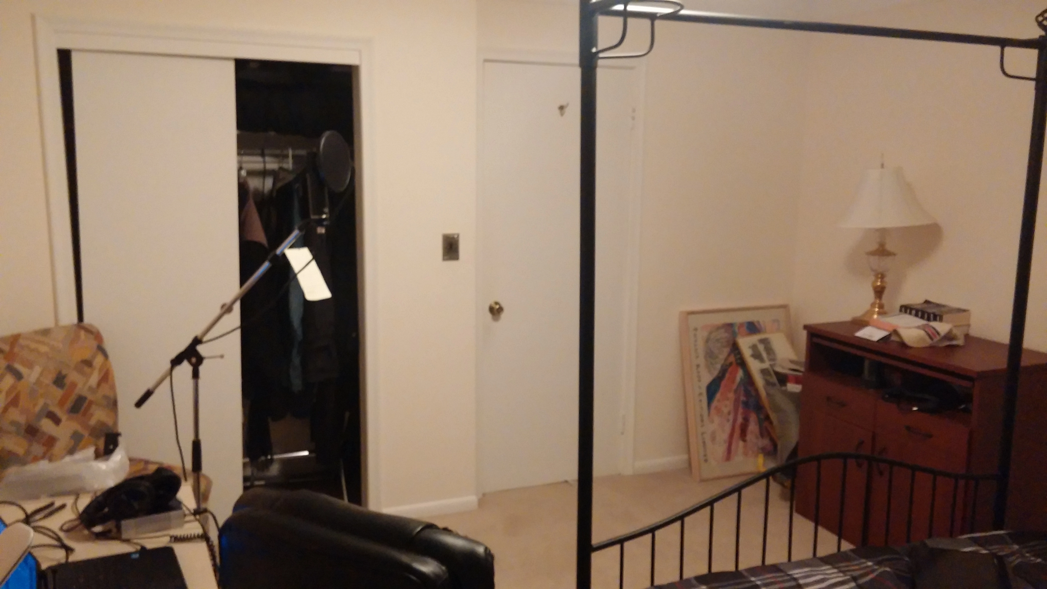

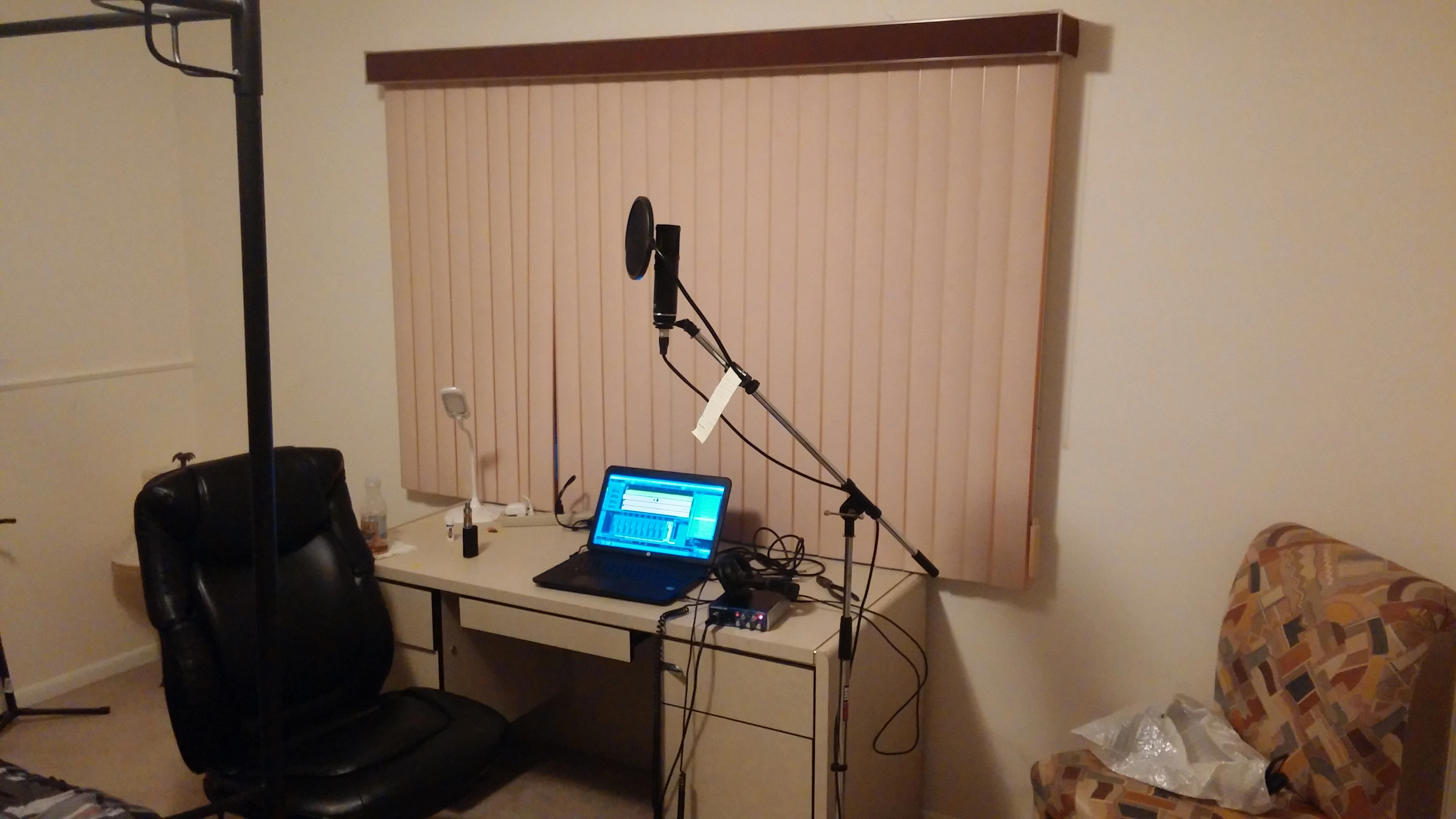

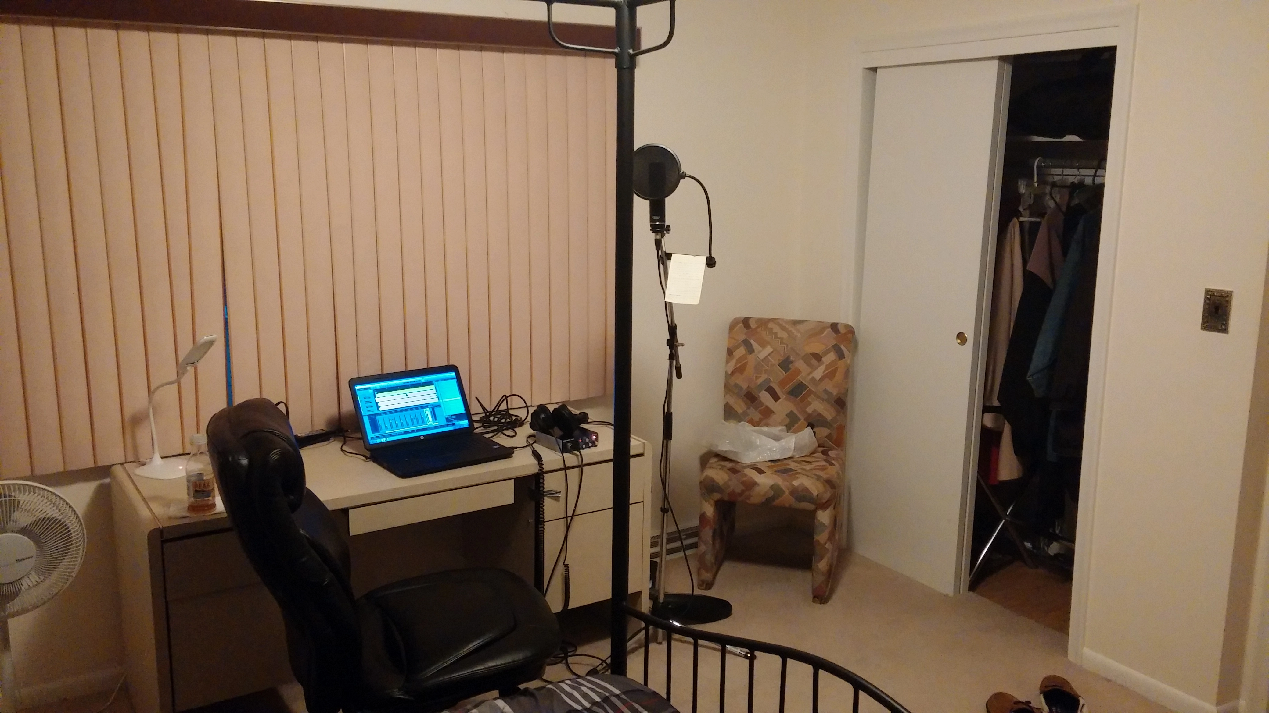

hey, would anyone recommend a better spot for the mic in this room? I'm using an otherwise unused space for my recordings. Some of you might know that my vocals are often the most complimented aspect of my tracks, but i'm wondering if I could make them even better by moving the mic to a different in this room. It's carpeted, one window (with curtain closed) and 10, or so, foot ceilings. Move it to a corner? middle more? facing which way? open to suggestions, though, again, i'm pleased with the sound...just wondering if something even better could be accomplished by positioning. thanks!

Looks like a pretty empty reflective room. Do your raw vocals sound particularly live or ambient? Is it a good thing?
If there's unwanted ambience you'd probably get more out of room treatment than mic position, but both are worth experimenting with for sure.
Recommendations are good but take a few hours one day and just track the same chorus 5-10 times.
In the corner facing in...corner facing out...centre of the room...closer to a wall.
Keep all the recordings totally dry for fair comparison.
If that closet door slides right into the wall it might be worth trying a mic position where the closet is behind you, off to the side a little.
There'd be fewer reflections coming straight back at the mic if the full closet was in line of sight.

Some of the stuff you've got in there would diffuse better than a painted wall, at least.

First reflection points are the closest points on the walls/floors/ceilings where sound comes from you, bounces, and hits the mic.
So, if there's a way to have anything but a flat shiny surface at your first reflection points, that's bound to make an audible difference.
(open closet, open door, heavy dense materials....I dunno)
Singing diagonally across the room is another thing to try; That way the reflections to your left and right aren't coming straight back at the mic.
It looks like you're set up for that in the pics?
Yes, I set it up so it's more in the middle of the room for the least reflections nearby. Carpet is best, no? I've got that. When I open the door, too much sound from the house gets in. I keep it closed. That window picks up stuff...but in the mix, can't hear it.
I guess I just wanted to know if there was something obvious that anyone would point out from the pictures. Like..."oh Jesus. Get it out of there and move it against the wall by chair" whatever etc... If there's nothing so "wrong" , I'll either leave it or try with my back to the corner .
I would be standing in the threshold of the closet (same door open as in photo), facing into the room not quite toward the opposite corner. Less reflection from behind you courtesy of the closet, longest distance of reflection courtesy of the angle.
John's idea is the same as I was going to say. Keep the room reflections from getting back into the side of the mic you're singing into. Hang an old duvet across that corner )clip to the closet and window frames, and use it behind you, facing out into the longest dimension of the room.

Well really then, the answer (and the same ones I would have said), were given in the first several posts! (Steenamaroo, Masive', Mjbphotos..) Get your back and the 'hot side of the mic up in or near the only non-reflecting place in there. And/or hang some soft stuff up around you and the mic.
