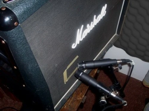

This is how I usually mic guitars:
thanks for the advice. I will try recording again with two sm57. One on axis and how about the other sm57? also on axis?

See the pic above ;)
