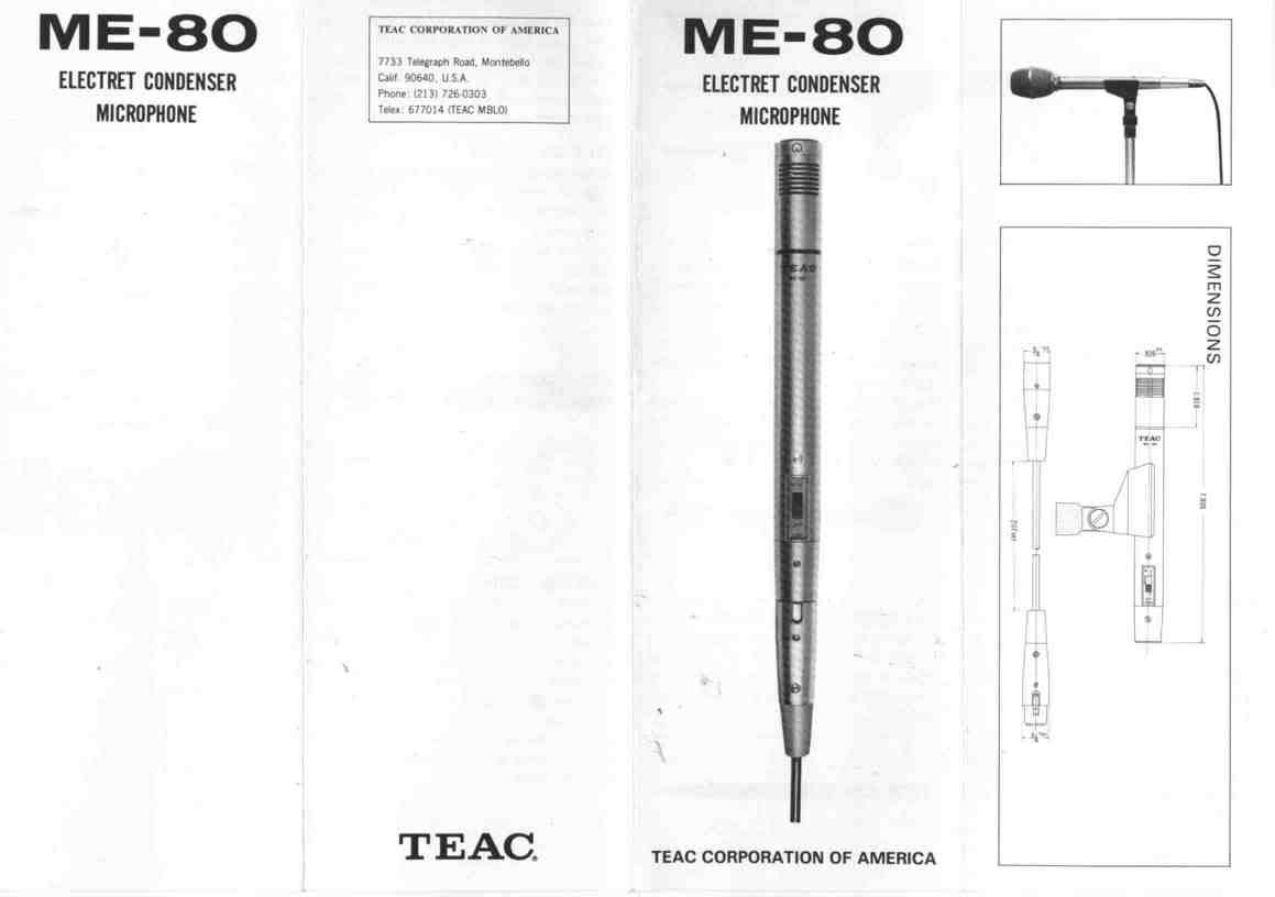

I presume it's this:-
This got me for a mo. as the only ME 80 I knew about was the Sennheiser one - the short gun head for the K3 system.
