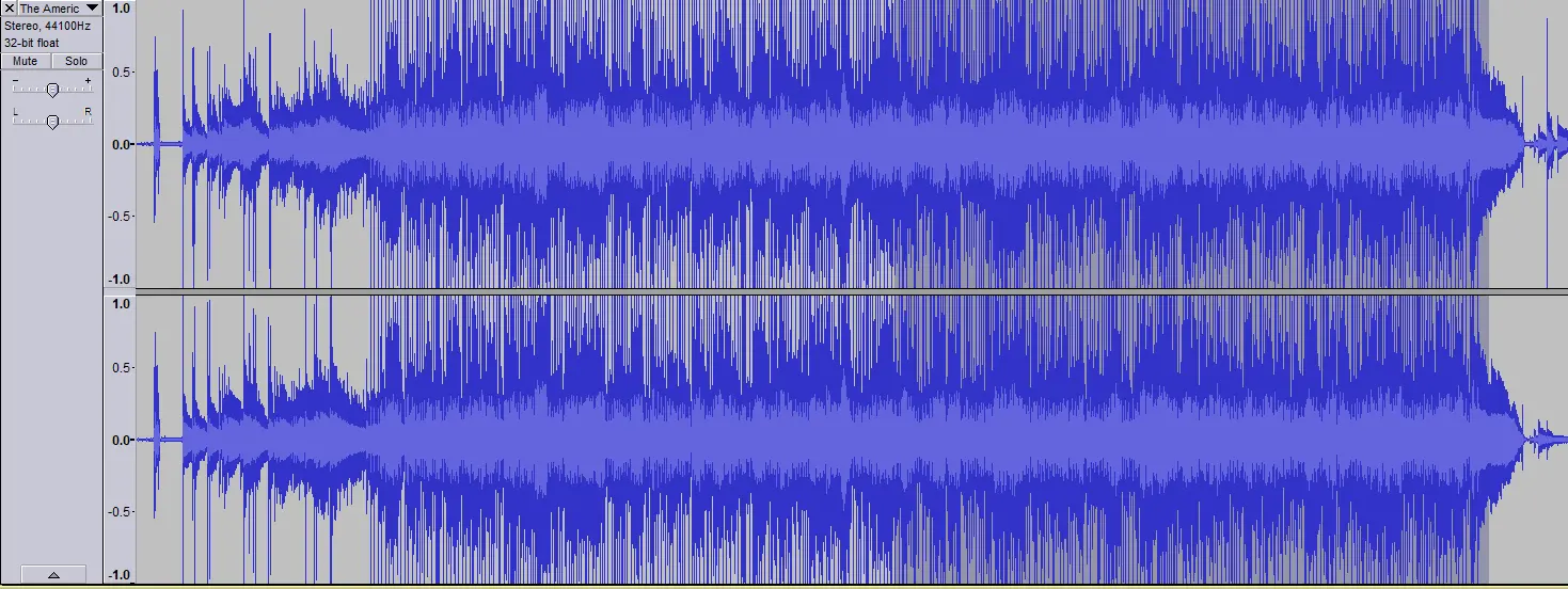

This is maybe limited too hard?
Wondering about the overall mix. Too harsh. Bass too loud?
Comments welcome. Thanks

This piece is certainly coming across nicely but you’ve indicated some concerns already that it might be limited a tad too far. The bass doesn’t sound too loud in the mix to me - if anything it could be louder to my ears. The guitars sound good. Drums do sound slightly intense/overcompressed perhaps? agree with slimcharles42 here, on the snare especially. Spantini highlighted the call and answer between the vocal and guitar which is indeed very nice. I personally think the vocals sound good but perhaps just a teeny touch too loud. The real highlight for me here is the lyrics, really like what you’ve come up with lyrically. One of the chord changes is also quite Beatle-esque to my ears and that’s always a winner.

vox too loud? yes no doubt about that.

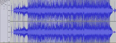

my concern for overlimiting is due to the waveform.
as you can see it's up there. but that doesn't automatically mean it'll be harsh. yeah :yawn:
thanks
